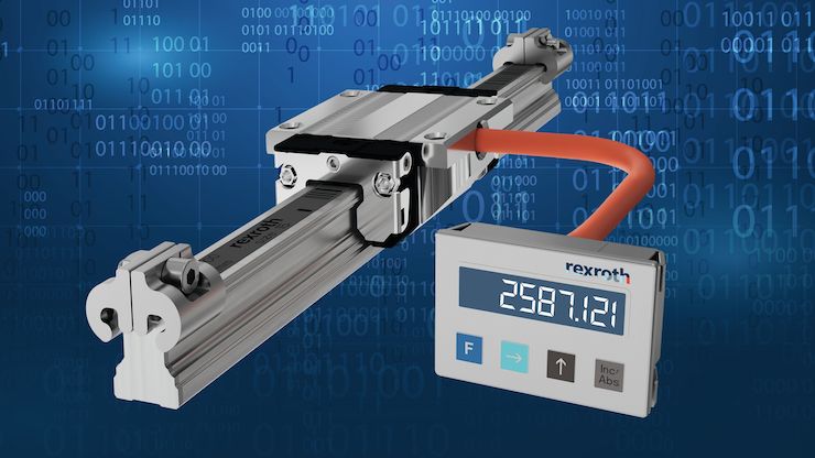

The IMScompact measuring system from Bosch Rexroth fully integrates the measuring sensor in the runner block, saving installation space.

Integration of feedback devices has become more common in linear components, an example of this would be the IMS-C. With IMS-C, there is no additional measuring device required. Traditionally, the measuring device is difficult to add because of the machine alignment, but IMS-C makes this seamless with the sensor integrating into the runner block.
