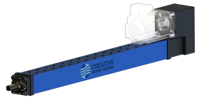

Roller-screw actuators often include electric motors, servodrives, switches, and even controls. Shown here is a roller-screw actuator from Creative Motion Control that is oil filled to address the heat associated with high speeds and loads … and for installation-orientation flexibility as well as zero-maintenance operation. Circled in red is the actuator’s CMC Grooved Roller Bearing (GRB) based on the same fundamental concept as the roller-screw mechanism — except with a zero lead. Force density is high, and load capacity and life are matched to that of the roller screw (with its roller assembly circled in purple).

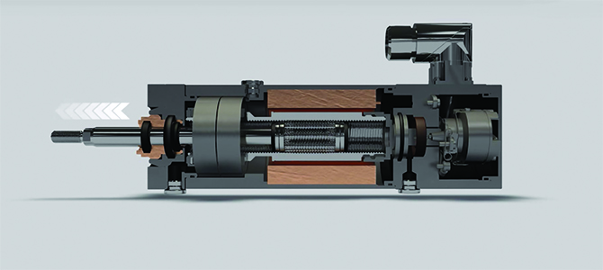

Other standard roller-screw actuators prioritizing compactness affix motor magnets to the nut’s outer diameter. Then motor-stator windings incorporate into the actuator housing’s I.D. to wrap around the nut and electromagnetically interact with the magnets. This in turn prompts nut rotation and (via the rollers) advancement of the actuator shaft.

Roller screws require none of the valves, filters, and pumps of fluid-power systems. In some cases, parts count is further reduced by the integration of motor windings into the actuator. Image courtesy Diakont

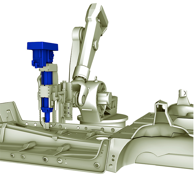

Shown here is a riveting application that uses a roller-screw-based linear actuator from SKF Motion Technologies to boost process speed and throughput. Joining with riveting is common in automotive and other industries that aim to keep vehicle or design weight low and strength high, because riveting doesn’t deform sheet metal or change its material properties. The SKF roller-screw actuators exhibit excellent shock resistance thanks to full-ground 60 Hrc steel roller screws.
Even so, roller screws excel in the machine-tool and packaging applications mentioned, as well as weld guns, injection-molding equipment, and presses. Axes that are traditionally driven by hydraulics (as in sawmills and lumber-processing machinery) are another place where roller screws make sense, as the omission of hydraulic fluid prevents staining of end product even while maintaining the power required for intensive large-scale processes. Other roller-screw applications include those with large temperature variability or high-force operations.
