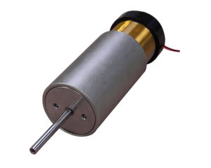

Moticont’s new GVCM-051-089-05S06 linear voice coil motor features high speed, high acceleration/deceleration, zero backlash, high accuracy, high repeatability, and an internal shaft and bearing.
This compact, voice coil motor has a high force-to-size ratio with 5.5 lb (24.6 N) continuous force and 17.5 lb (77.7 N) of peak force with a housing measuring just 2.000 in. (50.8 mm) diameter x 3.50 in. (88.9 mm) long. The stroke of the motor is 2.75 in. (69.9 mm) and the precision ground shaft with a diameter of 0.2360 in. (5.99 mm) has an internal thread. The housing has threaded mounting holes for easy integration into current and future applications.
This low inertia brushless actuator features high reliability and is ideal for a number of applications including medical devices, assembly equipment, work holding and clamping, antenna positioning, as well as in testing, laser machining and drilling, wafer handling, optical focusing, scanners and laser beam steering and filtering. The linear voice coil motor can also be ordered as a complete plug-and-play system including a controller.
