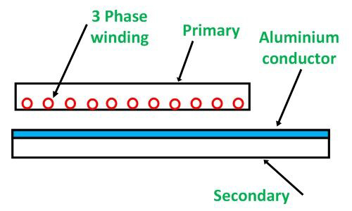

Like permanent magnet linear motors (commonly designated as ironless and iron core types) linear induction motors consist of a primary part (analogous to the stator in a rotary induction motor) and a secondary part (analogous to the rotor in a rotary version). The primary consists of a three-phase winding assembled on a steel lamination stack and encapsulated in epoxy.
The secondary consists of what is commonly referred to as a “reaction plate” — a conducting aluminum or copper plate, typically with a steel backing. (The steel can be omitted, but the motor’s force will be significantly reduced.)
When power is supplied to the primary, magnetic flux develops and travels across the length of the primary. Eddy currents are induced (hence, the term “induction” motor) in the conducting material of the secondary. The magnetic flux of the primary and the induced currents of the secondary interact to produce a linear force.
Linear bearings are necessary in linear induction motors to maintain the proper air gap between the primary and secondary parts. The linear bearings also support the attractive forces that occur between the primary and secondary when the motor is powered.

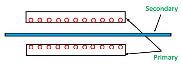

A common variation is the double-sided linear induction motor (DSLIM or DLIM), in which the reaction plate passes between two primaries that face each other. For DLIM designs, the reaction plate is only made of conductive material (aluminum or copper) and does not include steel backing. The double-sided design produces higher thrust forces and eliminates the attractive forces between the primary and secondary parts.

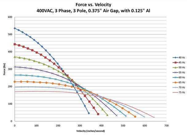

The thrust produced by a linear induction motor is a factor of the supplied voltage, the amount of slip, and the size of the air gap, as well as the influence of end effects. And because linear induction motors have lower efficiencies, cooling can have a measurable effect on the motor’s ability to produce thrust. For this reason, manufacturers typically provide both force-velocity and force-duty cycle charts for selecting a motor.
