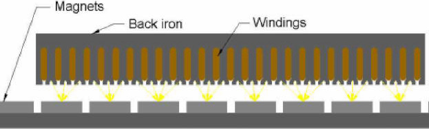

Linear motors are generally classified by the construction of the motor’s primary part: ironless or iron core. In an ironless linear motor, the windings of the primary are embedded in an epoxy resin, whereas the windings of an iron core linear motor are mounted in an iron lamination stack. The lamination contains teeth, or protrusions, that focus the electromagnetic flux towards the magnets of the secondary part. Windings are mounted in the slots between the teeth.
This design provides a strong magnetic attraction between the primary and the secondary and allows iron core linear motors to produce very high forces, but the lamination slots cause a phenomenon known as cogging.
As the slotted primary part travels across the magnets of the secondary, it has “preferred” positions relative to the magnets. In order to keep the motor in motion when the primary reaches these preferred positions, more force is required. This force variation (and resulting velocity ripple) is known as cogging. Cogging reduces the smoothness of motion of iron core motors and typically makes them less suitable than ironless designs for applications that require smooth, constant force or velocity.

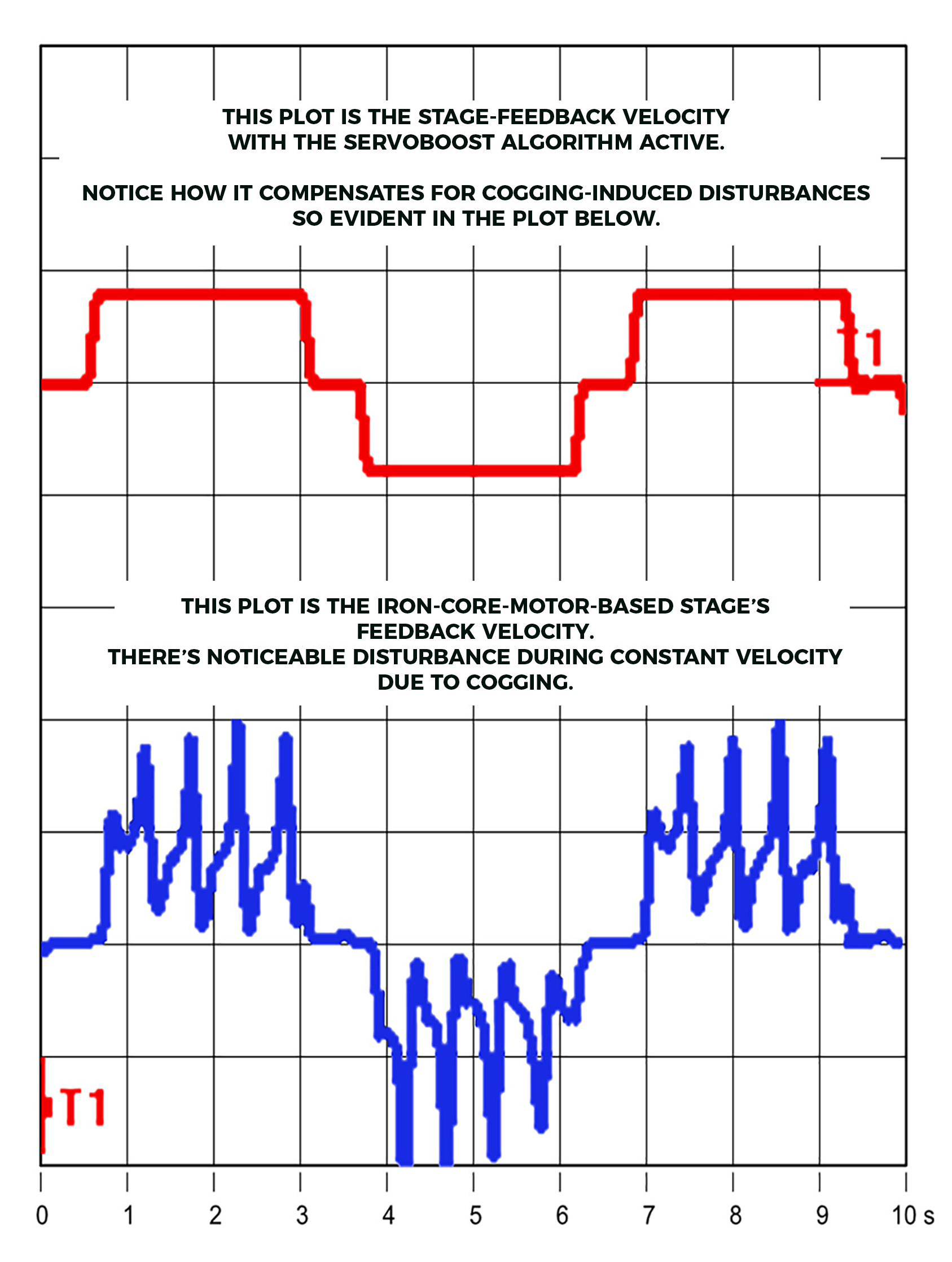

In addition to these mechanical solutions, many servo drives and controllers include algorithms that can compensate for cogging forces. This is done by adjusting current to the motor in order to minimize variations in force and velocity. Anti-cogging algorithms can help iron core motors achieve motion that rivals ironless versions in smoothness and consistency.
cogging
Advanced servo algorithms, such as ACS’ ServoBoost, can identify and compensate for cogging in iron core motors so they deliver performance that’s the same as or similar to that of ironless motors.
