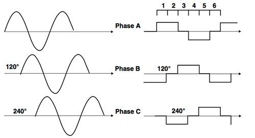

Permanent magnet brushless DC (BLDC) and synchronous AC motors are often differentiated by the way their stators are wound and the commutation method they use. Permanent magnet synchronous AC motors have sinusoidally wound stators and use sinusoidal commutation. This means that current to the motor is continuously controlled, so torque output remains very constant with low torque ripple.
For motion control applications, permanent magnet AC (PMAC) motors may use a more advanced control method known as field oriented control (FOC). With field oriented control, the current in each winding is measured and controlled independently, so torque ripple is reduced even further. With this method, the bandwidth of the current control loop and the resolution of the feedback device also affect the quality of torque production and amount of torque ripple. And advanced servo drive algorithms can further reduce or even eliminate torque ripple for extremely sensitive applications.
In contrast to PMAC motors, brushless DC motors have trapezoidally wound stators and typically use trapezoidal commutation. With trapezoidal commutation, three Hall sensors provide information on the position of the rotor every 60 electrical degrees. This means that current is applied to the windings in a square waveform, with six “steps” per electrical cycle of the motor. But current in the windings can’t rise (or fall) instantaneously due to the windings’ inductance, so torque variations occur at each step, or every 60 electrical degrees.
sinusoidal vs trapezoidal control
Sinusoidal control (left) allows smooth torque production, while trapezoidal control (right) produces torque ripple every 60 electrical degrees.
Image credit: STMicroelectronics
Because the frequency of the torque ripple is proportional to the motor’s rotational speed, at higher speeds, the motor and load inertia can serve to smooth out the effects of this inconsistent torque. Mechanical methods to reduce torque ripple in BLDC motors include increasing the number of windings in the stator or the number of poles in the rotor. And BLDC motors — like PMAC motors — can use sinusoidal control or even field-oriented control to improve the smoothness of torque production, although these methods increase system cost and complexity.
