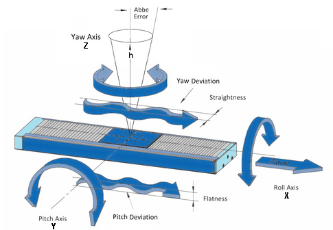

Linear motion systems can exhibit three types of errors: linear errors, angular errors, and planar errors.
Linear errors are errors in positioning accuracy and repeatability, which affect the system’s ability to reach the desired position.
Angular errors — commonly referred to as roll, pitch, and yaw — involve rotation about the X, Y, and Z axes, respectively. Angular errors can lead to Abbé errors, which are angular errors amplified by distance, such as the distance between a linear guide (the source of the angular error) and the tool point of a measuring device. It’s important to note that angular errors are present even when the stage isn’t in motion, so they can have a negative effect on static operations such as measuring or focusing.
Planar errors occur in two directions — deviations in travel in the horizontal plane, which is referred to as straightness, and deviations in travel in the vertical plane, which is referred to as flatness.
abbe error
Angular errors include roll (rotation about the X axis), pitch (rotation about the Y axis), and yaw (rotation about the Z axis).

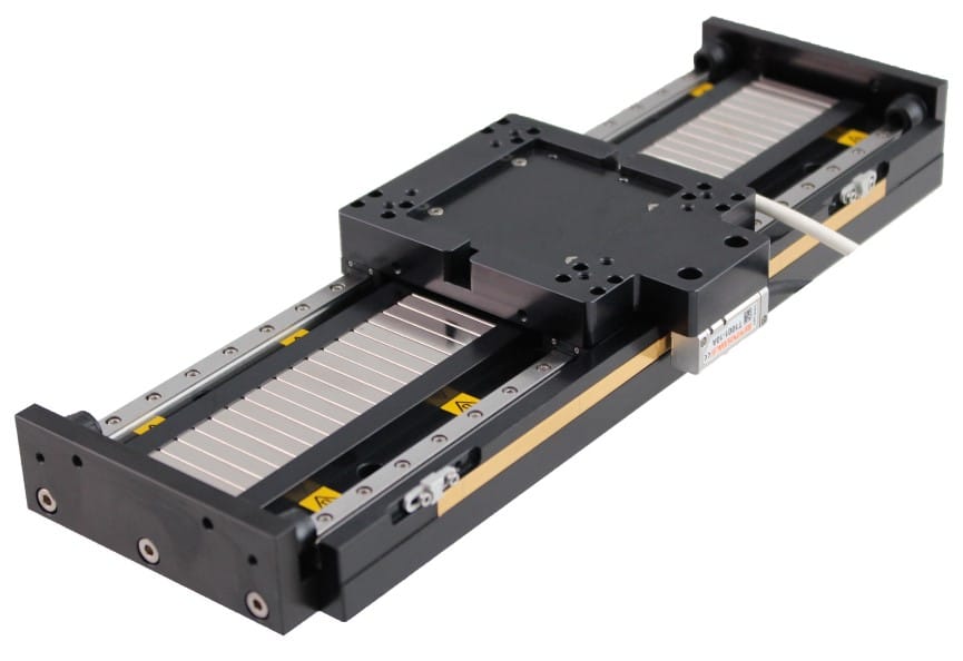

Although there are no rules or strict guidelines for what constitutes a linear stage, they’re widely recognized as the most precise category of linear motion systems. When a system is referred to as a linear stage, it’s generally understood that the system will provide not just high positioning accuracy and repeatability, but also low angular and planar errors. To achieve this level of performance, there are several principles that manufacturers generally follow in terms of construction and the type of components used in the stage design.
linear stage
This linear stage uses profiled rail recirculating bearings with a linear motor drive.

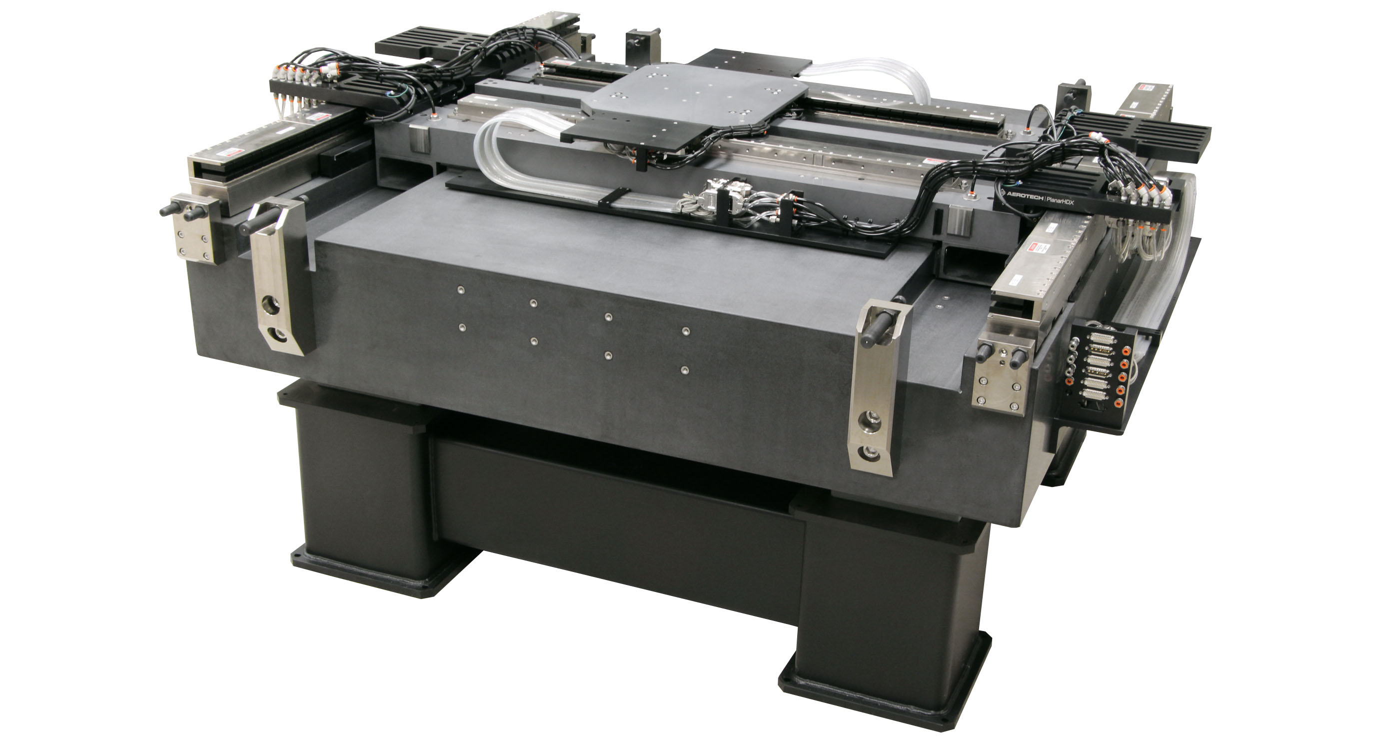

Although the term “linear stage” implies a single-axis motion system, stages can be combined to form multi-axis systems such as XY stages, planar stages, and gantry stages.
linear stage
This two-axis gantry stage uses air bearings and linear motors on a ceramic base.
