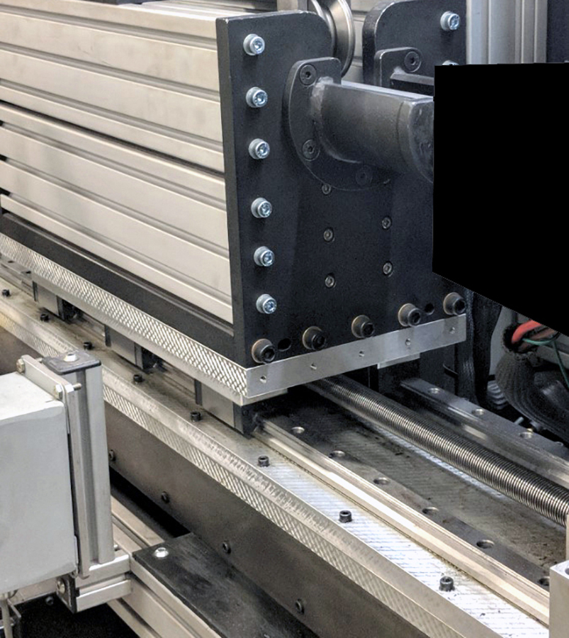

Unacceptable compromises on travel, speed, force, and accuracy can result in degradation of overall machine throughput as well as shorter maintenance intervals and premature failure — not to mention complicated modifications to off-the-shelf linear slides. In contrast, custom solutions can help linear axes deliver on all counts — even on exceptionally long axes such as the one here. Image courtesy LM76

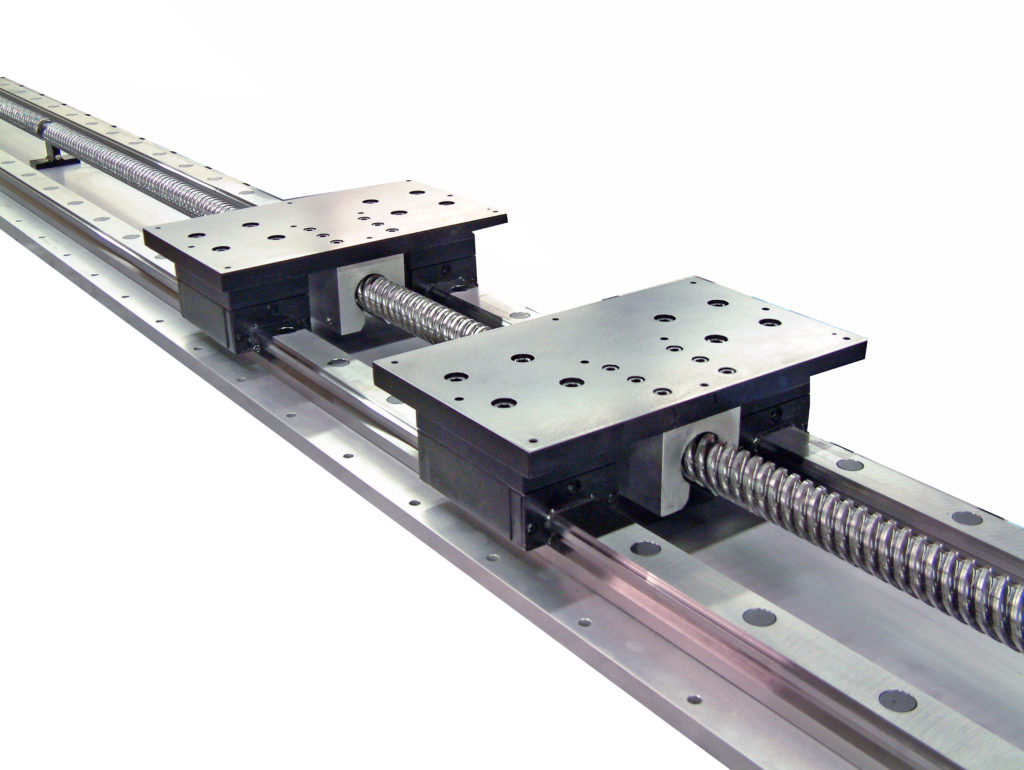

Here’s a closeup of round-rail linear slides on a ballscrew-driven linear stage.

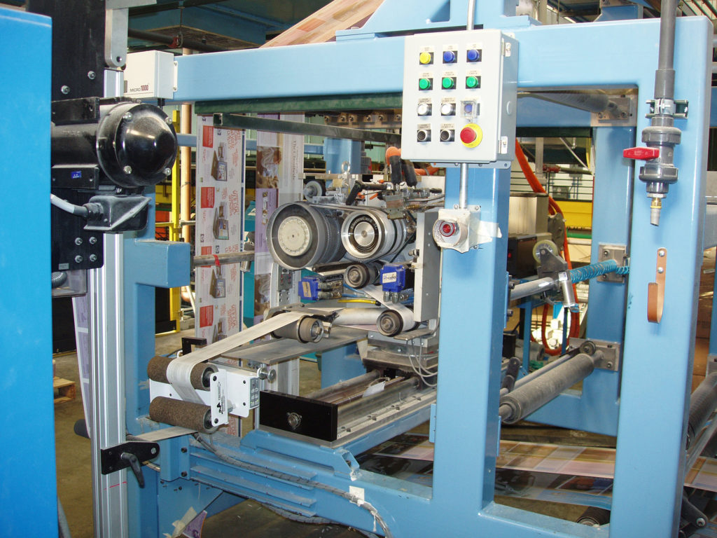

Shown here is a machine integrating profiled rail linear guides.
Shown here is a machine integrating round-rail linear slides.
