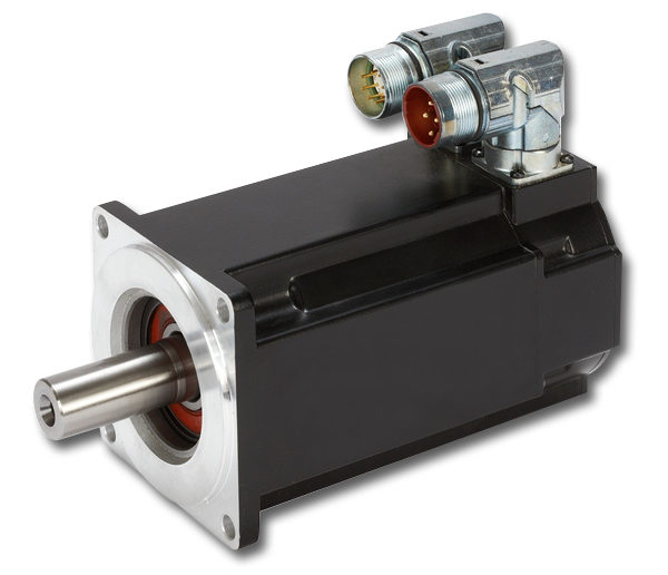

AC motors: Synchronous or asynchronous
AC servo motor
Synchronous AC motors provide high torque density and excellent dynamic performance.
Image credit: Kollmorgen
AC motors can be further divided into two categories: synchronous and asynchronous, depending on the speed of their rotating field. For a synchronous motor, the rotor turns at the same rate as the stator’s rotating magnetic field, which is referred to as the synchronous speed. Synchronous AC motors have a high torque density and excellent performance in dynamic applications, so they’re often used in servo systems. Synchronous AC motors are also referred to as permanent magnet AC (PMAC) or brushless AC (BLAC) motors.

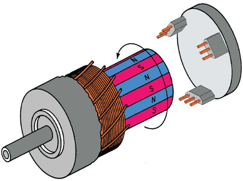

DC motors: Brushed or brushless
DC motors are subdivided into brushed and brushless versions, depending on whether they’re mechanically commutated (with brushes and a commutator) or electronically commutated (via Hall sensors or other feedback).
servo motor
A brushless DC (BLDC) motor with three Hall effect sensors to detect rotor position.
Image credit: Honeywell International, Inc.
Both brushed and brushless DC motors can be used in servo systems, although brushed motors are less common in servo applications due to the wear and associated maintenance of the brushes and commutator.
When brushed motors are used in servo applications, the configuration of choice is typically a permanent magnet stator (as opposed to a wound stator), which is a design often referred to as a permanent magnet DC (PMDC) motor.
Brushless DC (BLDC) motors, on the other hand, are well-suited for servo applications due to their high efficiency and reliability, low rotor torque (which improves dynamic response), and linear speed-torque relationship.

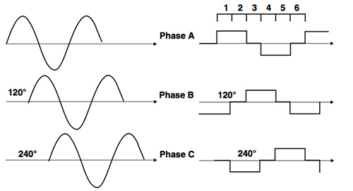

Are synchronous AC and BLDC motors the same?
Like the synchronous AC motors described above, BLDC motors also use permanent magnets on the rotor and run at synchronous speed. And technically, the voltage that runs a BLDC motor is converted from AC to DC through a DC bus and electronic circuitry. So many experts argue that these two motor types are the same technology, and group them together in the category of permanent magnet synchronous motors (PMSM). But the stator windings differ between synchronous AC motors and brushless DC motors, and this difference affects their operation and performance.
waveforms
Sinusoidal (left) and trapezoidal (right) current waveforms for synchronous AC and BLDC motors, respectively.
Image credit: STMicroelectronics
In BLDC motors, the stator coils are trapezoidally wound and produce a trapezoidal back-EMF waveform, which tends to produce audible noise. Commutation is achieved in six steps (every 60 degrees), which generates torque ripple. Synchronous AC motors, on the other hand, have sinusoidally wound stators and use continuous, sinusoidal commutation, which eliminates the torque ripple experienced by BLDC motors. This makes synchronous AC motors the preferred choice for high-performance industrial servo applications.
