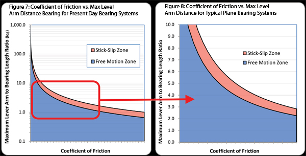

A graph can be created showing what the maximum allowable Binding Ratio would be for any coefficient of friction. Figure 7 illustrates that the smaller the coefficient of friction, the larger the Binding Ratio can be. For this figure, Equation 14 was used and the bearing length, L1, was set to a value of L1 = 1. The X-axis shows different values for the coefficient of friction, μ, and the Y-axis shows the Binding Ratio.
For illustration purposes, the lowest common coefficient of friction commonly found in linear motion systems today is in recirculating ball type linear guides where the coefficient of friction can be as low as μ = 0.001. Using Equation 14, and setting the bearing length to 1, the result is a Binding Ratio of 500:1. The highest coefficient of friction found in modern day plane bearings is μ = 0.5; however, most modern day materials have a value of μ = 0.1 – 0.25. Figure 7 graphically illustrates the importance of a low coefficient of friction for applications with a high moment load and a large moment arm distance.
coefficient-of-friction
The assumption was made that all forces are applied in an axis that is parallel to the direction of travel. This assumption eliminates the complication and redundancy of vector mathematics. In most practical applications, the force would actually be applied at some non-parallel angle, which would require the force to be broken down into its X-Axis, Y-Axis and Z-Axis vectors. The end result would be the same. The only difference is that the formulas would have to be repeated three times, once for each axis.
Stick-slip
One of the most frustrating and potentially devastating problems an engineer can face is stick-slip motion. It can bring production to a standstill until the problem is solved. While we have covered the coefficient of friction (μ) as if it was a single value, in reality, every material has two coefficients of friction: static (μs) and dynamic (μk). In general, the coefficient of static friction is greater than or equal to the coefficient of dynamic friction. This value will certainly be different for every material, so be sure to check the specific value for designed in materials.
Remember, the greater the coefficient of friction, the lower the Binding Ratio will be. Thus, the difference between the static and dynamic coefficient of friction means that there could possibly be some designs that will work when the system is already moving, but will not work when the system is at rest. Figure 7 plots the Binding Ratio for different static and dynamic coefficients of friction. Figure 8 is a detail view of Figure 7.
There are two curves plotted in each figure. The top curve represents the Binding Ratio curve based upon the static coefficient of friction. The bottom curve represents the Binding Ratio for the dynamic coefficient of friction based upon the assumption that the dynamic coefficient of friction is 35% less than the static coefficient of friction. The blue area at the bottom of the plot is the “free motion zone” where motion will not theoretically be interrupted by binding due to the Binding Ratio. The red area is the area between the curves of the Binding Ratio for the static and dynamic coefficients of friction. The white area above the curves is the “no motion” zone where it is likely that motion will not occur. Stick-slip is more likely to occur for applications where the Binding Ratio is in the red zone (the area between the curves).
Figures 7 and 8 are not meant to be used as an engineering reference chart, rather, they should be used for illustration purposes only. Linear recirculating ball based systems often have static and dynamic coefficients of friction which are almost identical, so there is little change in the binding ratio. Plane bearings typically have a larger difference between the static and dynamic coefficient of friction, so there will be a larger variance in the binding ratios.
Stick-slip is often described as a temporary cycle of alternating rest and motion. Some systems experience stick-slip motion only at certain locations during the cycle. If this type of motion is repeatedly observed at the same location, then it is likely that an unknown force is acting upon the system at that location.
The most common external forces are caused by misalignment of the linear rails, change of dimension for the rails, or an imperfection in the rail (which can also be caused by damage). These additional forces are not accounted for in Figure 5 and all of the equations here. These forces must be multiplied by the force of friction and then added to the resultant forces from the moment load. Looking back to Equation 10, it can be rewritten as Equation 16 to account for these additional forces. Provided that the applied force, F1, is still larger than the frictional forces, then motion will still occur. However, if the sum of the frictional forces exceeds the applied force, binding will occur.
Equation 16: Acceleration = 0 → F1 = μ (F2 + F3) + μ(other forces)
Since the system was likely in motion before these additional frictional forces were applied, the momentum of the system will help push through the momentary zone where these external forces are applied. As the system moves through this zone, the applied force will re-engage to cause a short burst of motion before resulting in binding again. The momentum will again help push the system through the binding where the cycle can repeat. This is stick-slip in its simplest form.
