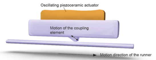

In an ultrasonic piezo motor, the piezo actuator is electrically excited to produce high-frequency oscillations. The actuator is preloaded against a runner via a coupling element. When the actuator oscillates, the coupling moves along an inclined path at the same frequency, making contact with the runner and causing it to move linearly.
piezo motor
Operating principle of a linear ultrasonic piezo motor.
