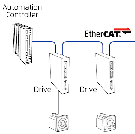

Servo systems are made up of four key parts: a motor, a feedback device, a servo drive, and a motion controller. The servo drive and motion controller work together (supported by information from the feedback device) to provide the correct power to the motor so that it executes the intended movement or produces the desired torque. The motion controller’s role is to determine what needs to be done to achieve the desired position, velocity or torque — it takes care of the higher-level processing and decision-making. The motion controller sends this information to the servo drive, which produces the voltage that energizes the motor windings and causes the motor to rotate or produce torque.

Servo drive + motion controller = servo controller
The term “servo controller” is sometimes used as an umbrella term for the parts of the system responsible for controlling the motor — the servo drive and the motion controller. Although here we talk about the components of a servo system as individual pieces of hardware, in reality, they are often integrated to various levels. Case in point: nearly all servo motors include an integrated encoder for feedback. And servo motors with integrated drives are extremely common, with some designs integrating traditional motion controller functions as well.
Feature image credit: Advanced Motion Controls
