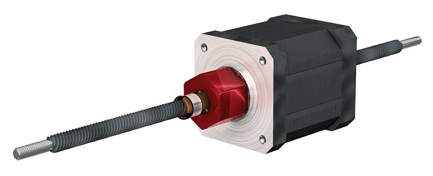

lead screw stepper motor
Lead screws are often used in stepper motor actuators, for a cost-effect, easy-to-use linear motion solution.

Recall that lead screws rely on sliding contact between the screw shaft and the nut, and so have inherently high friction and, in turn, low efficiency. This means they require higher torque from the motor in order to turn the screw and create linear motion. And recall that stepper motor torque drops significantly at higher speeds, so lead screw + stepper motor combinations aren’t typically a good choice for high-speed applications that require high, or even moderate, torque production.
