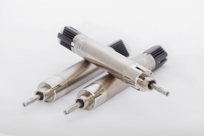

In 2000, another linear motor was introduced to the market — the moving-coil actuator. The development of neodymium magnets is key to this device. Moving-coil actuators are dc devices that use a series of static coils to move magnets mounted on a piston. They are servo devices that allow programmable control of position and velocity. They also allow programming of forces. Because the piston is a relatively light mass, these are the fastest linear actuators on the market.
Moving-coil actuators (also called voice coil actuators) satisfy an array of design objectives. Within the actuator are permanent magnets generating a magnetic field; a moving coil resides in that field. Passing current through the coil generates traverse motion of it and the output shaft or shuttle.
Just as moving magnet linear-motor actuators, moving-coil actuators also have long cycle life. Current input is in the 1.5-A range due to the low moving mass. Stroke is limited to about 500 mm. Output force is comparable to that of pneumatic actuators. Price is about two to three times that of pneumatic actuators — and continues to drop.
