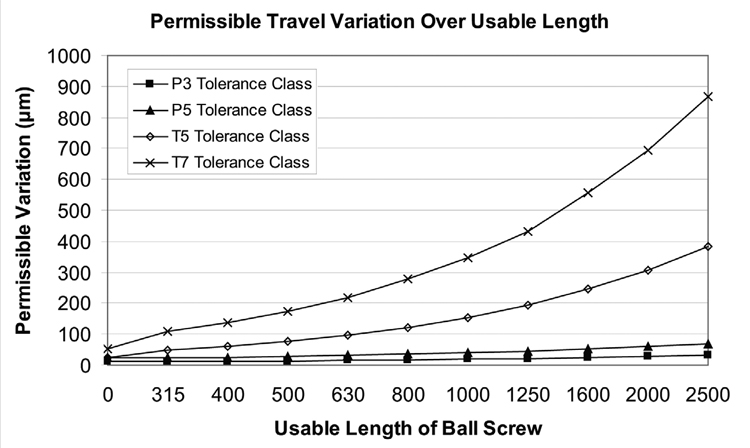

Unlike lead screws, which have backlash between the nut and the screw, ball screws can be, and often are, preloaded to remove backlash. This is typically done by using balls that have a slightly larger diameter than the space between the raceways of the screw and the nut. (Some lead screws are offered with nut designs that eliminate backlash, but these typically add friction and reduce efficiency.)
In addition, ball screws are classified by ISO, DIN and JIS standards regarding their lead deviation, so choosing the proper accuracy class ball screw is straightforward.
ball screw
International standards (ISO, DIN, and JIS) define the allowable travel deviation for each      ball screw accuracy class.
