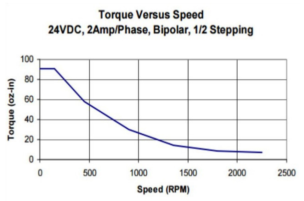

In stepper motor applications, if the operating boundaries — as defined by the motor’s torque-speed curve — are exceeded, the motor can lose steps or stall. While a stalled motor can disrupt the manufacturing or assembly process, lost steps can be especially detrimental, since the open-loop control system has no way to detect that steps have been lost. This is why many stepper motors are over-sized for the application’s defined operating parameters — to give some measure of safety, or torque margin, in case of unforeseen operating conditions. But when the application is well-defined, with predictable loads that don’t undergo significant changes, a properly sized stepper motor can provide very accurate, reliable positioning under open-loop control.
High torque at low speeds
Stepper motors produce maximum torque when the motor is at standstill and continue to provide very high torque at speeds up to 1000 or 1200 rpm. Servo motors, on the other hand, often require a gearbox to multiply the torque and reduce the speed from the motor. But the addition of a gearbox reduces system stiffness by introducing backlash and compliance. Since stepper motors don’t require mechanical gearing to produce high torque at low speeds, they also have an advantage in overall system stiffness for these applications.

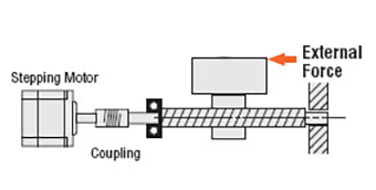

Holding a load in a fixed position
Because they produce full torque at standstill, stepper motors are able to hold a load in place, even against external forces. This is especially useful in processing applications, where a load is held stationary while some operation — such as assembly or machining — is performed, or while waiting for the next movement. Closed-loop systems can also hold loads, but because they constantly correct for any errors between the commanded and the actual position, the load is never truly at standstill, as the motor continuously “hunts” for its commanded position. Because there is no feedback loop to force position corrections, stepper motors with open-loop control are able to hold a load at a precise location without hunting.
