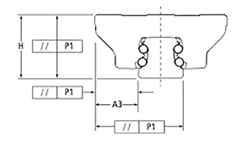

Traditional profiled rail accuracy classes define five characteristics: the height and width tolerances of the rail and carriage assembly; the permissible differences in height and width of multiple carriages on the same rail; and the parallelism between the rail and carriage reference surfaces.
Standard profiled rail and carriage accuracy classes specify tolerances for height (H), width (A3), and parallelism (P1).
Image credit: Thomson Linear

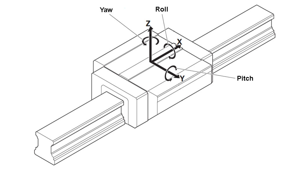

But as the carriage travels along the rail, it also experiences rotational deviations, in the form of rolling (rotation around the X axis), pitching (rotation around the Y axis), and yawing (rotation around the Z axis). These rotational deviations aren’t covered by the standard profiled rail accuracy classes, but manufacturers are beginning to address them.

Traditional accuracy classes don’t address rotational movements of the block, which include roll, pitch, and yaw.
Image credit: Bosch Rexroth Corp.

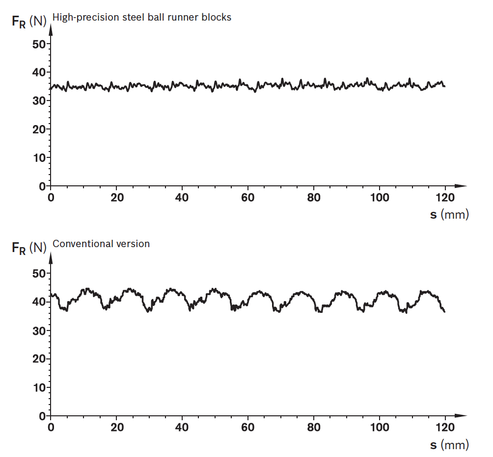

In a recirculating linear bearing, as the balls (or rollers) transition into and out of the load-bearing zone, they make the transition from being unloaded to being loaded (or vice-versa) not in a smooth, linear fashion, but in pulses. This effect on the load-bearing balls causes pronounced rotational movements of the carriage.
To reduce these dynamic motions, manufacturers have put significant effort into optimizing ball (or roller) recirculation. Two common methods are the use of a flexible steel insert to guide the balls from the non-loaded to the loaded state and dampen the forces that occur during the transition, or a longer entry zone to allow a more gradual transition from the non-loaded to the loaded condition.
Regardless of the method used, smoothing the transition of the balls (or rollers) through the entry and exit zones of the carriage reduces the pulsations that cause rotational movements. Improving the pulsating nature of the ball transition also reduces friction forces in the carriage, and more importantly, variations in friction forces that can cause the system to overshoot or undershoot position in highly sensitive applications.
Frictional drag of profiled rail carriages with optimized recirculation (top) versus conventional versions (bottom).
