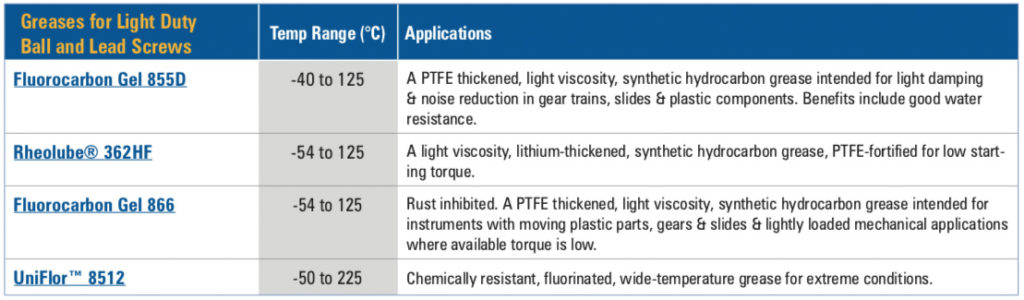

When external lubrication is deemed beneficial, the designer or engineer can choose between grease/oil or a solid lubricant. If grease or oil is chosen, there are formulations suitable for lead screw applications that require high travel speeds, clean room compatibility, and a variety of temperature ranges. But keep in mind that these lubricants, particularly grease, can attract and trap dust and other fine particulates that are abrasive to the lead screw assembly and can reduce the life of the screw and the nut.
lead screw
Grease and oil options for lead screw lubrication provide a wide variety of temperature ranges and chemical compatibility.

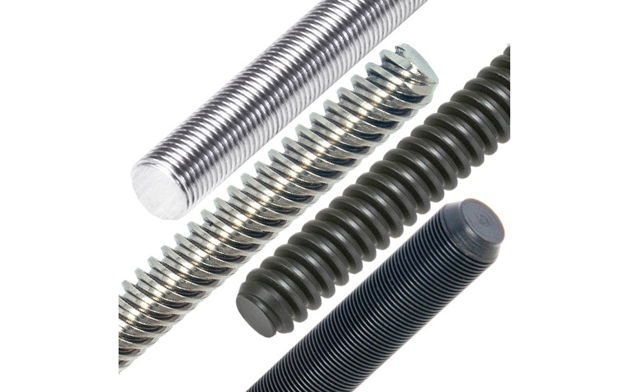

The term “solid lubricant” usually refers to a PTFE-type coating (known under the brand name, “Teflon”), which is by far the most popular solid lubricant for lead screws. Some manufacturers offer their own proprietary formulations, but most use PTFE as the primary lubricating component. Solid lubrication is typically applied by the manufacturer with a spray method to achieve a very precise, even thickness, and then cured.
lead screw
Lead screws are commonly made from carbon or stainless steel. The addition of a PTFE-type coating protects the screw and provides lubrication for the nut.
Image credit: AMETEK, Inc.
Solid lubricants provide better protection than oil or grease against liquid contamination — water, acid, or alkaline — and often permit a wider range of operating temperatures. They are also the best option in situations where grease and oil are not allowed, such as medical and optical applications. While the friction coefficients of solid lubricants are higher than those of grease or oil (PTFE has a friction coefficient range of 0.06 to 0.12), the coefficient of friction remains constant regardless of preload or applied load, which ensures consistent torque requirements and smooth operation over the life of the lead screw.
