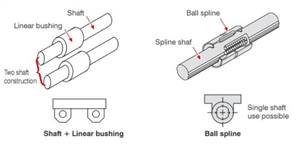

One shaft takes the place of two
Traditional linear bushings are almost exclusively used in dual-shaft configurations in order to prevent the bearings from rotating as they ride on the shafts. But since ball splines are inherently anti-rotation, they can be used in single-shaft configurations. And replacing two shafts with one also means a smaller footprint, less weight, and easier alignment and assembly.

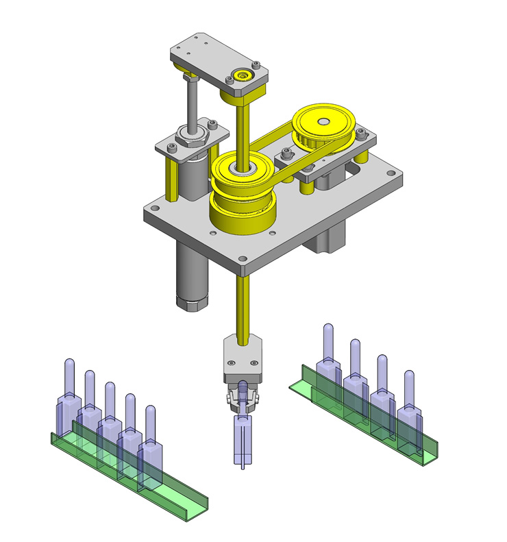

Pick-and-place or assembly applications can also benefit from rotary ball splines. For example, transferring a part from one workstation or conveyor to another might involve picking the part from the first conveyor (vertical motion), rotating to the position of the second conveyor (rotary motion), and placing the part on the second conveyor (vertical motion). In this case, a rotary ball spline can be driven by a combination of a pneumatic cylinder for the linear motion and a belt and pulley system for the rotary motion.
