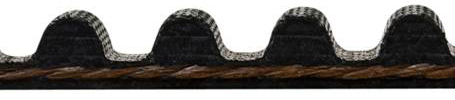

Belt manufacturers typically offer their own exclusive or patented tooth designs, but even proprietary designs are based on one of three basic profiles—trapezoidal, curvilinear, or modified curvilinear. Each one offers benefits in power transmission, speed capability, or backlash.
Although timing belt tooth profiles are based on just three basic designs, belts with the same type of tooth profile and the same tooth pitch may not be interchangeable. This is due to variations in tooth dimensions between manufacturers’ designs, and in some cases, even within a given manufacturer’s product line.

Curvilinear belt tooth profiles
The curvilinear tooth profile was developed to alleviate the stress concentrations found in trapezoidal profiles and improve on torque and speed capabilities. Curvilinear profiles also have a larger tooth depth than trapezoidal designs, so belt ratcheting is less likely. And the smoother transition that curvilinear teeth provide during mesh means these profiles are quieter than their trapezoidal counterparts. The tradeoff, however, is that curvilinear designs have higher backlash than trapezoidal profiles.
The curvilinear tooth profile was developed by Gates, and belts with this profile were referred to as high torque drives (HTD). Although various manufacturers use different names, the HTD designation is still quite common for belts with curvilinear tooth profiles.
