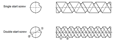

But a high-lead screw has a great deal of “dead” space between the ball tracks — space that can be used for additional, independent ball tracks. And more ball tracks means more effective turns, more load-carrying balls, and higher load capacity.

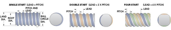

A ball screw with multiple, independent ball tracks is referred to as a “multi-start ball screw.”

The terms “lead” and “pitch” are often used interchangeably, but they refer to different aspects of a screw’s design. The lead of a screw is the linear distance traveled for each complete revolution of the screw. Pitch is the distance between screw threads.
For a single-start screw, the lead and pitch are equal. But for a multi-start ball screw, the lead equals the pitch multiplied by the number of starts, or, conversely, the pitch equals the lead divided by the number of starts. This is because the pitch measures the distance between screw threads, regardless of whether the threads are of the same start, or track.
