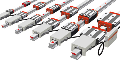

Integrated Measuring
Manufacturers offer integrated measuring systems for a wide range of both ball and roller rail systems.
Image credit: SCHNEEBERGER

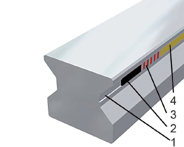

Integration of the measuring system covers both parts—the scale and the read head. The scale is conventionally mounted in a groove that is machined into the side of the rail. The scale is protected by a laser-welded cover, which provides a dust-tight seal and protection against water ingress (IP67 and IP68 ratings are common for integrated measuring systems).
In the Schneeberger AMS system, the magnetic strip (2) is mounted into a ground slot (1) on the side of the rail. The strip is ground and magnetized (3), and then a protective cover (4) is welded to the rail.
