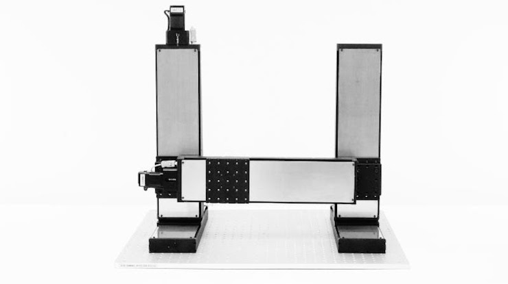

A new overhead XY gantry from IntelLiDrives is built with precision ball screw actuators. The gantry features travel lengths from 100 to 600 mm, with speeds to 100 mm/sec and resolution to 5 microns.
The gantries can be motorized with stepper motors, brushless servo motor/encoders or integrated SMART motors. Contact-less end-of-travel limit sensors are also installed on these systems. Gantries can also be fitted with an optional third rotary module axis for XYR configuration.
The XY gantries are supplied with a self-supporting rigid structure for industrial applications.
