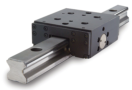

Linear guide rail brakes play a critical role in many linear motion applications by ensuring that the guide carriage and payload do not move under load.
Precision linear motion is an important requirement for a range of machinery such as packaging machines, metal-cutting machine tools, woodworking machines and medical systems, among others. Many linear motion applications require the ability to stop the motion at various points while work is performed. Rail brakes provide an efficient method of stopping linear motion by providing holding force on profile rail guides in a package small enough to work alongside linear bearing blocks. Rail brakes must be capable of providing reliable, high holding force while ensuring low backlash for accurate positioning. One very popular design uses a series of spring engaged/pneumatic released pistons to apply a clamping force. The design uses a wedge and roller mechanism on the non-bearing contact surface of the guide rail. Selecting the correct rail brake for a particular application begins with calculating the maximum holding force required by the application. Next, select a brake, or brakes, that will deliver that force while ensuring that the brake fits the profile rail.

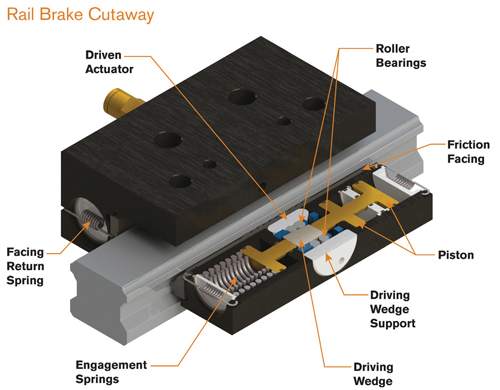

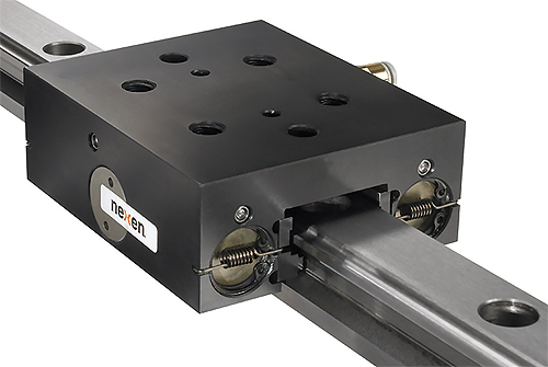

Rail brakes ride under the carriage and are attached between the bearing blocks. The rail brake holds the carriage in position by applying friction to the profile rails. Rail brakes are carefully designed not to brake on the rail surfaces that engage with the bearings to ensure no reduction of bearing life. Most rail brakes are designed primarily for static load holding applications since the motor itself can be used to stop the payload dynamically. The rail brake provides rigidity and accurate positioning required to achieve high levels of quality and throughput in a range of operations such as CNC machining and precision assembly among others.
A popular rail brake design uses springs to apply clamping force through friction pads onto the profile rails, thus locking the payload of the linear motion system in position. The springs continuously deliver clamping force while pneumatic pistons provide the force needed to release the brake when they are actuated. In order to securely grip the rails, the friction facings on the rail brakes need to be designed to match the size and geometry of the rails. The larger the rails used in the application, the greater the holding force that the brakes are able to apply.
The spring engaged/pneumatic released approach previously mentioned provides consistent holding force by tightly pressing the friction facings against the rail. This approach provides low backlash (typically within 0.002 in.). Braking systems integral with the motor or drive system produce higher backlash because the backlash includes not only the backlash of the brakes, but also the backlash of the drive system. The spring engaged/pneumatic released design also uses a low volume cylinder so it doesn’t require as much compressed air as typical brakes.

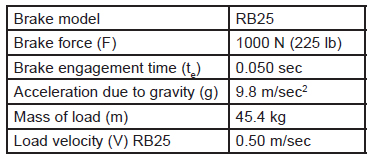

In emergency stops, the brake also has to absorb the kinetic energy built up by the carriage and payload of the linear motion device. In many such applications, a predetermined maximum allowable stopping distance has been determined. The formulas below can be used to predict horizontal or vertical stopping distance based on the holding force of the brake. Sample calculations are also provided based on the data below.
Sample data
Horizontal Travel (X and Y axis)
Stopping time at full brake force:
ts = (m • V)/F = (45.4 • 0.50)/1000 = 0.023 sec
