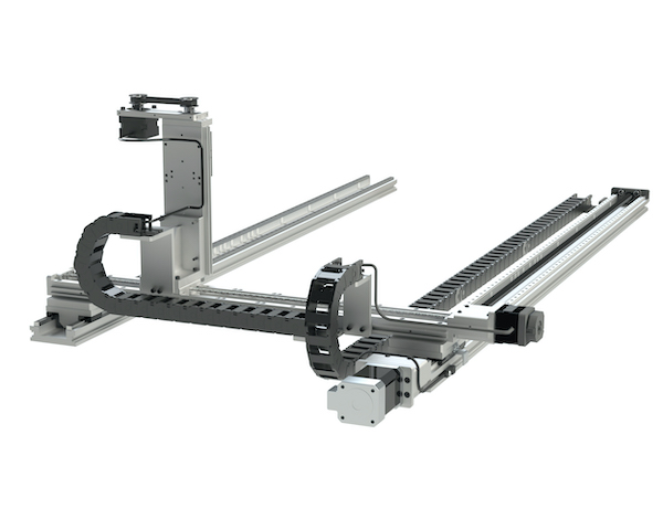

linear actuators
Off-the-self servo- or stepper-driven electrical linear actuators integrate well with PLCs to provide a high-performance motion control solution for all types of machine automation applications.
