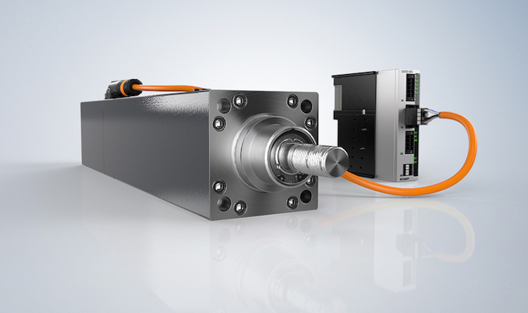

A Beckhoff AA3100 electric cylinder with a compact ELM servo drive.
