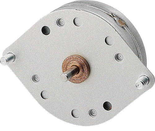

Portescap-Can-Stack-42L
The 42L048D can stack stepper from Portescap is the basis for the can stack linear actuator. Its large rotor and neodymium magnets provide up to 18.5 oz-in. (131 mNm) of holding torque, making it a good fit for high torque applications.
