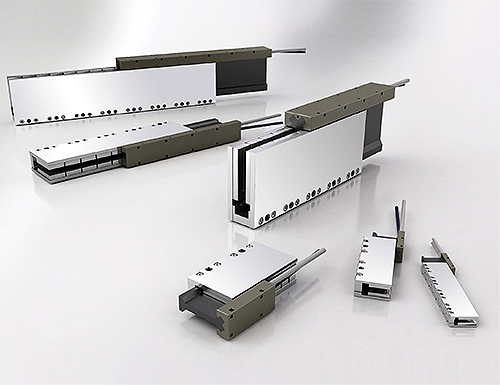

Linear motors deliver superior output, so excel in medical equipment, industrial automation, packaging, and semiconductor manufacturing. What’s more, new linear motors address the cost, heat, and integration complexity of early versions. To review, linear motors include a coil (primary part or forcer) and stationary platform sometimes called a platen or secondary. Subtypes abound, but the two most common for automation are brushless ironcore and ironless linear motors.
chieftek-linear-motor-lineup
Linear motors generally outperform mechanical drives. They have unlimited lengths. Without the elasticity and backlash of mechanical setups, accuracy and repeatability are high and stay that way over the life of the machine. In fact, only the guide bearings of a linear motor need maintenance; all other sub-components are wear-free.
