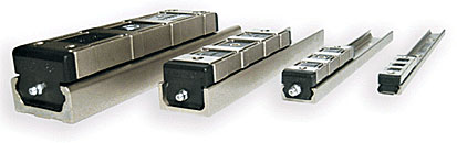

First the basics: Linear guide rails, guideways, and slides are mechanical systems composed of rails and bearings that support and move physical loads along a linear path with a low coefficient of friction. They are usually classified as rolling element or plane bushing types. Because many shapes and sizes are available from various manufacturers designed to satisfy specific engineering needs, your unique application determines the list of critical parameters that you should consider as well as their order of importance.
The most common types of guideways and bearings include profiled (square) rails with recirculating ball bearing blocks, guideways for roller bearings, and round rails with recirculating ball bushings or plane bushings.  Profiled rails suit applications that require exceptional rigidity and precision, such as in machine tooling heads and precision circuit board movements. Roller bearing systems are intended for a wider range of applications such as lifting and transferring parts, or pick-and-place applications.
To select which of the rails work best for an application, first, analyze the system’s specific needs. Next, understand the customer’s  requirement or program guidelines, which include the number of axes, repeatability, tolerance, and accuracy required to achieve the end result. Finally, consider environmental contamination, such as dust, water, fibers, and other substances.
For any system, the operating environment determines the type of bearings that need to be selected. For instance, dirty environments can contaminate the assembly and interfere with the proper functioning of re-circulating ball paths. The contamination is more manageable in roller systems because the rolling elements are generally larger. Plane bearings suit applications where surface-contact lubrication is not recommended or cannot be exposed to the environment such as in certain research laboratories or silicon chip manufacturing facilities.

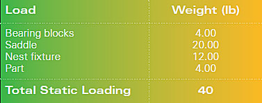

Static load consists of the weight of the saddle, nest fixture, payload, and bearings. If 40.0 lb is centered horizontally fore/aft and left to right in a typical dual rail and four carriage set, each of the bearing blocks would be statically loaded at 10.0 lb.nov-mech-feat-6.jpg

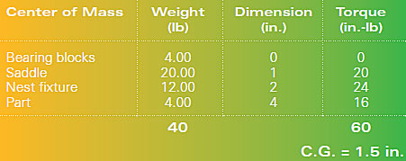

When sizing the bearings, organize the load parameter and its distance to the center of gravity (C.G.) or center of mass. Load refers to the weight or force applied to the system, which includes both the static and dynamic loading. The static load comprises the weight of the saddle, nest fixture, payload, and bearings. The dynamic (or kinetic) loading must account for the applied loads as they interact with the bearing-laden saddle. Normally this load would place a torsional requirement on the bearings. The C.G. for the saddle provides a single load value at some distance from the bearing centers.
These dynamic values as well as static loading values can then be organized as radial (Corad), axial (Coax), torque about “X” axis (Mx), torque about “Y” axis (My), and torque about “Z” axis (Mz).  The variables can then be used in most any bearing sizing application to select to the appropriate size of carriage.  Loading values are normally presented in lb or Newtons (N) statically and in.-lb or Newton Meters (Nm) for dynamic loading.
The center of the individual loads are a relative distance to the center of the guideway system or bearing centers, the total mass has a C.G. distance to the guide rails of 1.5 in. (60 in.-lb/40 lb).  The bearings would have to manage a torque load of 60 in.-lb, especially as the saddle is accelerated or decelerated quickly.

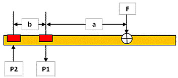

In addition to the standard horizontally balanced saddle, two other forms of common loading for linear applications include cantilevered conditions. Here, P1 = P2= (a/b)F + F.  The total load for the most statically stressed slider is set as the worst-case scenario for sizing the bearing or carriage.
The other cantilevered application typically occurs when moving loads vertically. With one rail and two carriages, both the bearing carriages can be loaded equally in a radial direction because P1 = P2 = F(a/b).
