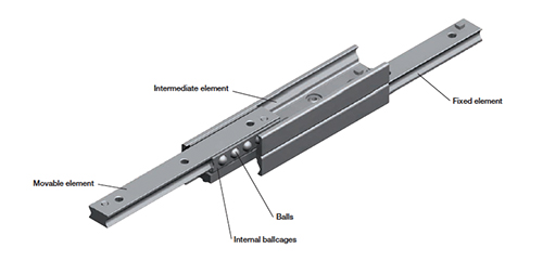

Telescoping bearings offer partial, full, and over-extension stroke options. Why is it important to identify the extension you need, and not just go with the longest possible (or practical) stroke option?
Rollon: Partial extension refers to an extension length less than the closed length – typically 50 to 65 percent. Full extension means the extended length is equal to, or 100 percent of, the closed length. And over-extension means the bearing’s extended length is greater than its closed length—up to 150 percent in most cases.
Telescoping rails can also be offered in “dual stroke” or “double stroke” configurations, which allow the load to be moved in both directions while maintaining the same closed length. One problem with this configuration is that the intermediate element does not always return to its closed position. To counter this, Rollon offers a version with a driving disk in the intermediate element, which brings it back to the correct position.
Telescoping Bearing
Components of a telescoping linear bearing

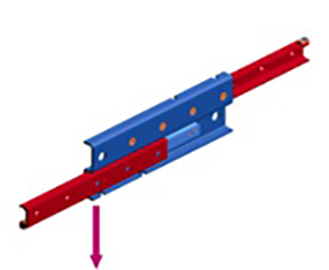

Another important factor is load placement. The center of gravity of the load should be placed as close to the mounted rail as possible. It should also be centered about the moving element to allow for even load distribution among the balls. Load calculations are normally made assuming that the load is properly distributed.
Telescoping Bearing Load Placement
Load placement is an important factor in deflection.
