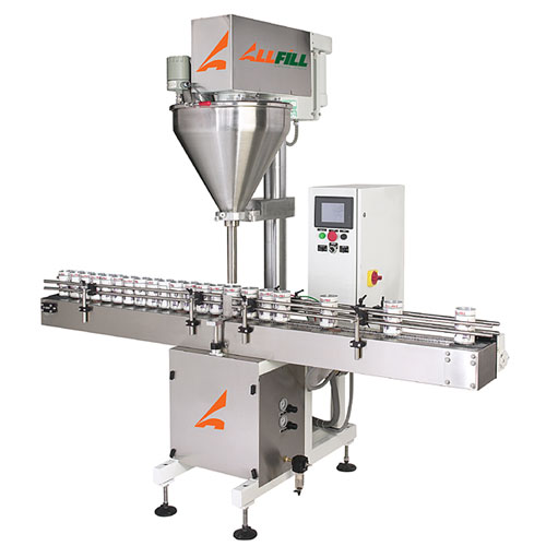

All-Fill’s automatic filling machine consists of a filling head and a motorized chain conveyor mounted on a frame base. Containers are moved into position under the filling head and lifted by the Tolomatic ICR Plus actuator so that the tube of the filling funnel begins to fill from the bottom. As the material starts to flow into the container, the container is lowered at a controlled rate. When completely filled, the container moves down the line and an empty container is lifted into position.
Located in a cabinet beneath an All-Fill powder-filling machine, the Tolomatic electric ICR SmartActuator lifts containers and then lowers them as they fill. The compact electric actuator facilitates quicker and more precise product changeovers compared to the pneumatic actuator it replaced.
The All-Fill automatic powder filling machine is used to fill ridged containers with a variety of dry products such as coffee, protein powders, baking ingredients and granulated bleach.
