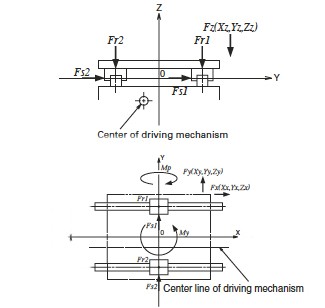

Even with the back-to-back arrangement, however, linear guides have a relatively short distance between the raceways (essentially equal to the width of the rail), which limits their ability to handle roll moments, which are caused by loads overhung in the Y direction. To counter this limitation, using two rails in parallel—with either one or two bearings on each rail—allows the roll moment to be resolved into forces on each bearing block. Since linear bearings have much higher capacity for forces than for moments (especially roll moments), bearing life can be significantly increased. Another benefit of using dual guide rails and allowing moments to be resolved into forces is that linear bearings generally deflect less under pure forces than under moment loads.
dual guide rails
When dual guide rails with one bearing each are used, no roll moments (Mr) are induced; only pitch (Mp) and yaw (My) moments.
Image credit: NSK Ltd.
dual guide rails
When dual guide rails with two bearings each are used, only downward (Fr) and side (Fs) forces are induced; no pitch, roll, or yaw moments.
