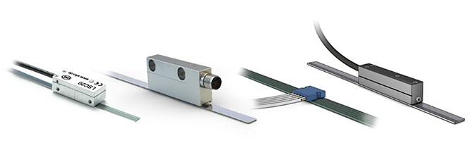

optical magnetic capacitive and inductive solutions for motion feedback
Shown here from left to right are optical, magnetic, capacitive, and inductive solutions for motion feedback.

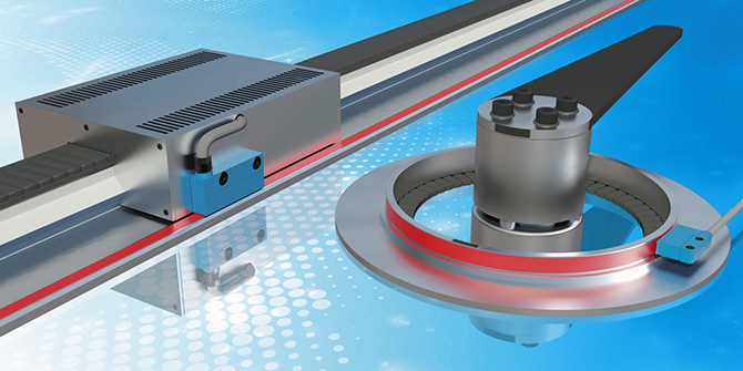

Shown here are two schematic views of motor feedback solutions — on linear and torque motors.
Most linear motors today include permanent-magnet arrays and a coil through which ac power is applied. The alternating field prompts the coil to advance through the varied magnetic field — or the other way around depending on what is fixed mechanically. Where the coil is integrated into a carriage, it moves along the magnet track while riding twin linear rails.
In contrast, torque motors for rotary axes are suitable for applications needing high torque and precise synchronization. These rotary direct drives work just like any other motor, but as a rule include a hollow center through which cables, compressed air lines, and other design elements pass or mount. Both rotary and linear direct drives necessitate feedback.

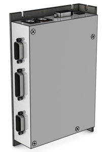

Modern controller solutions are indispensable for efficient drive engineering.

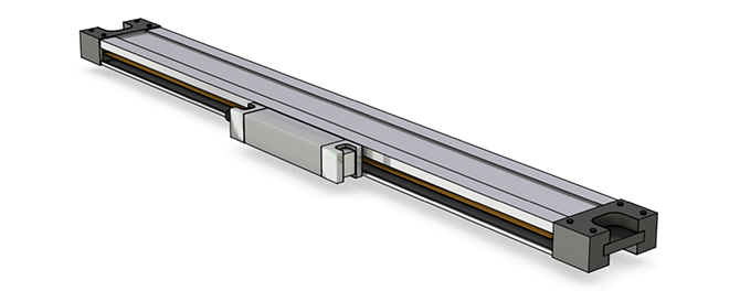

high-precision glass encoder scale with guided sensor head
Shown here is a high-precision glass scale with guided sensor head.
As mentioned earlier, a drawback of glass scales is their intolerance of mechanical impact, shock, and vibration. When used under such conditions, such scales require protective measures to prevent shattering. But the benefits of optical scales abound: The accuracy of many optical sensors reach ±5 mm and resolutions are to 0.05 mm. Optical-scale gradations (which partially define accuracy) are commonly to 20 mm. Then finer values are interpolated in sensor electronics and further processed by a system controller. High dynamics and the ability to return high-precision feedback with unbeatable accuracy, repeatability, and resolution even on very fast-traveling axes are key benefits of optical systems.

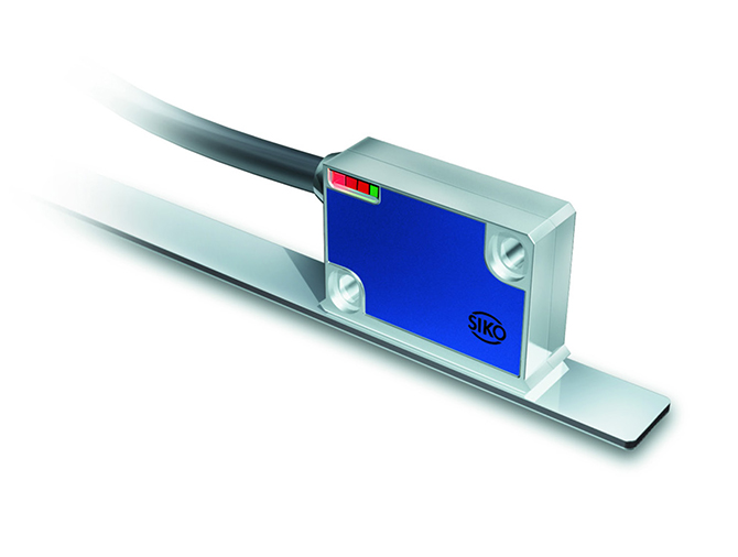

With magnetic measurement systems, the sensor travels sans contact over a magnetic tape (sometimes called a code strip) applied to a steel carrier a few tenths of a millimeter thick. This scale is magnetized with pole pitches to spur generation of digital signals when a read head passes over these magnetic poles and scans them. The read head recognizes the tape’s divisions and converts the resulting data into high-resolution path information for control electronics to use in adjusting servo commands.
Shown here is a high-resolution incremental magnetic sensor from the SIKO MagLine series. Engineers have used MagLine sensors on linear and rotary direct drives for many years. One exclusive variation from the SIKO product line is that of a magnetic feedback system that uses the motor’s magnets as the scale. Such designs must always be custom-designed and calibrated to the specific axis at hand — but that can be worthwhile where simplicity and eliminating additional cost for the scale benefit the overall design.
Consider one application — that of gantry drives with very long linear motors. Such designs must travel very quickly from one point to another but accuracy and precision requirements aren’t particularly strict. Here, one well-suited magnetic-sensing technology is that of a read head that uses the motor’s magnets as the linear scale.
Magnetic systems (just like inductive systems, which we’ll explore shortly) are resistant to dirt, oils, and humidity. In fact, magnetic scales can even work in areas of a machine subject to oil baths. Magnetic-based feedback also withstands shock and vibration for applicability in the most challenging designs — on off-highway and mobile equipment operating outdoors, for example. Magnetic measurement technology can also survive harsh applications such as stone and glass working. What’s more, the flexibility of the magnetic tapes means it can be shipped and stored coiled in rolls and then cut to size as needed.
Because the scale and even the mode of operation are so resilient, magnetic sensing lets design engineers mount the scale and read head fairly far apart if needed — even to several millimeters. This isn’t possible with other systems … for example, optical systems have such a delicate grid structure that the distance between the scale and head should never exceed a few tenths of a millimeter. While inductive technology has scale divisions of one millimeter to also allow wider scale-to-head distances, its read electronics tend to be bulkier than those of magnetic systems.
Drawbacks of magnetic systems are that they have lower absolute accuracy, resolution, and repeatability than optical designs. As mentioned, magnetic sensors are also sensitive to external magnetic sources of interference.

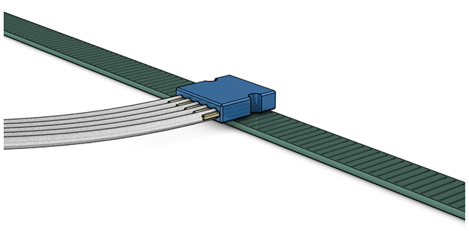

Capacitive-based motion feedback is based on interactions between two mutually chargeable plates. Position changes between a printed circuit board (PCB) scale and read head prompt the generation of an electric signal for use by a controller. Such feedback operation is applicable to linear motion but limited by scale length. That’s why capacitive-based feedback is far more common on rotary axes driven by torque motors. In fact, they’re often used where it’s too costly or complicated to integrate an optical glass scale into a motor shaft or rotor.
This is a capacitive scale in a compact design.
The main strength of capacitive-based feedback systems is cost effectiveness. That’s because the materials in capacitive sensors are inexpensive. In addition, capacitive sensors are designed to fit on specific rotary motor types — though this also tends to restrict their use with only a few motor-construction types.
The serious disadvantage of capacitive systems is their sensitivity to humidity. That’s why capacitive sensors are inappropriate for designs subject to washdown or where water is used to cool tools, for example.

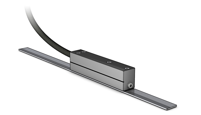

Inductive systems include etched scales just like optical systems. That means the reference gradient is also quite fine — though here the tape is made of steel. As with magnetic-based feedback, the scales can be quite long — so that 30 to 70 meters of coilable scale is common. The read head uses multiple small coils through which current is sent; current variations induced by traveling over the scale fields or slots form the signals from which relative movement or position is tracked.
Inductive measurement systems combine precision, high resolution, and repeatability.
The accuracy and resolution of inductive-based motor feedback are comparable to those of magnetic systems.
One key advantage of inductive systems is insensitivity to external magnetic fields. Inductive systems are slightly more expensive than magnetic offerings, mostly because inductive read-head electronics are more complex. The scales have comparable prices.

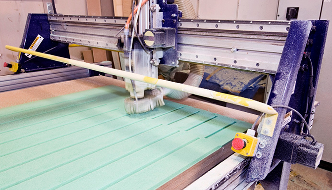

Machining: CNC-operated woodworking involves the milling of wood contours into mass-produced doors and furniture. Such operations generate sawdust that inductive and magnetic systems survive quite well.
In the same way, stone and glass working generate abrasive byproducts. But especially for window fabrication, relatively long linear motors must work quickly to efficiently transport tools between machining stations. High dynamics and fast adjustment of axes are needed — which means magnetic-based linear feedback is fairly common here.
Back in the semiconductor industry, so-called depaneling machines separate relatively large PCBs into smaller circuit boards. Usually dozens of smaller PCBs are held together by crosspieces. Snapping apart the separate boards generates a lot of dust — making magnetic measurement technology useful here too. Magnetic systems are also very compact — making them more appropriate than some inductive systems.
Magnetic motor feedback works reliably even in applications producing great quantities of dirt.

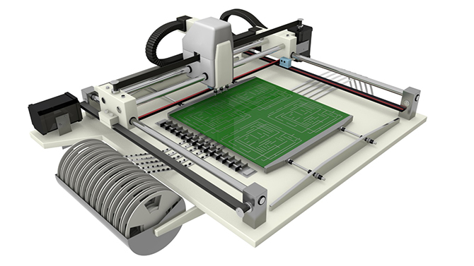

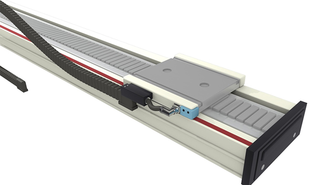

Pick-and-place applications: Precision is paramount in the automated populating of PCBs. Components including resistors, condensers, and microchips must be positioned exactly on the PCB before soldering. Optical and inductive systems are predominantly used for this purpose. But magnetic measurement technology can also be used if there’s low packing density and the design needs to be cost effective. Although the components used for populating PCBs are tiny and need precise guidance and positioning by the pick-and-place machine, magnetic sensors on some axes may be sufficient depending on the requirements for precision.
This pick-and-place unit includes linear direct drives fitted with SIKO magnetic-based feedback for position detection.
