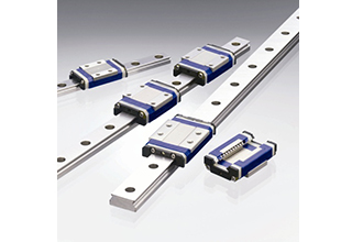

miniature profiled rails
IKO offers integrated lubrication on profiled rail sizes down to 3 mm.
Image credit: IKO Nippon Thompson

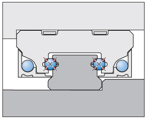

Another difference between standard and miniature profiled rail bearings is the retention of the balls in the bearing housing. This is important because virtually all standard sizes have balls that are retained in the housing, meaning they won’t fall out during general handling and installation. Because of their limited real estate, miniature versions generally don’t incorporate ball retention mechanisms, or if they do, they are only effective with extremely careful handling and installation. Because of the difficulties with ball retention, miniature profiled rail bearings are typically mounted on an arbor (essentially a plastic, “dummy” rail) during the manufacturer’s assembly and packaging. The arbor not only helps to retain the balls in the housing, but also aides with mounting the bearing on the rail.
Miniature profiled rails and bearings have two rows of load-carrying balls (one on each side).
Image credit: Bosch Rexroth Corp.
