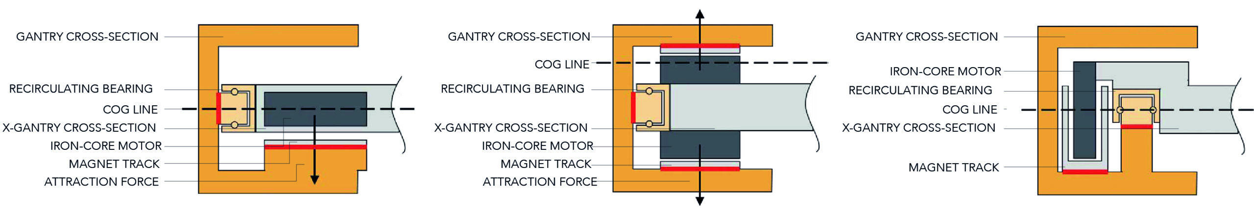

Next the stage drive type and arrangement are considered. Here it’s best to look for options making optimal use of the bearing stiffness and minimizing the number of surfaces needing expensive grinding tolerances. Certain fully optimized stages based on ironless motors (with moving coils) do this with a somewhat complex construction — but one that ensures the motor, linear bearing, and encoder all mount on the lower part of its C-shaped profile.
Click to enlarge. These are three options for stage drive type and arrangement as viewed perpendicular to the stage X axis. (All incorporate the C-shaped profile described in the article’s first section on topology.) Surfaces requiring expensive grinding tolerances are in red. Left: An iron-core motor force aligns with the plane of the linear bearings and the stage’s CoG … but the motor’s attraction force loads the bearings. Middle: Dual iron-core motors’ forces align with the bearings and stage CoG  … and the attraction forces cancel each other out. Right: The motor forces align with the linear bearings and CoG … and subject the assembly to no attraction force.

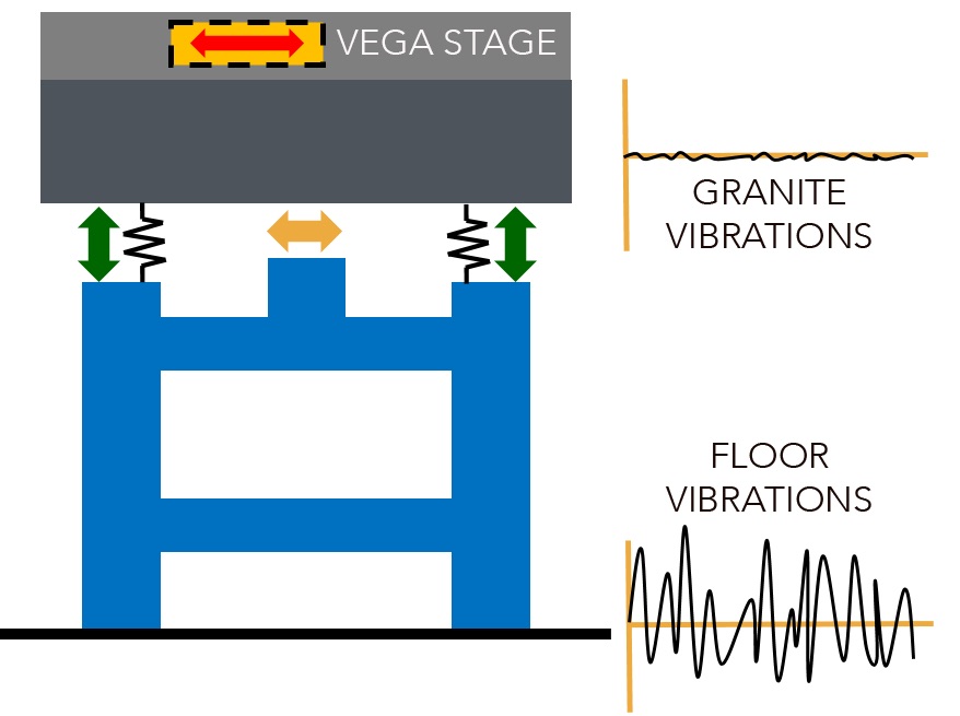

Demanding requirements of residual-vibration mitigation necessitates a vibration-isolation system. High acceleration requirements in particular put high lateral forces on the stage’s granite base … so the vibration isolation system must be active. The use of a balance mass to eliminate vibrations is nonviable here because such designs are excessively bulky.
This is a schematic representation of the Vega stage on an active vibration-isolation platform. Compliant springs prevent transfer of floor vibrations to the stage. Skyhook damping and an advanced floor feedforward algorithm (green arrows) further address vibration. The stage forces on the granite (red arrow) are counteracted by feedforward control (orange arrow). As the vibration-isolation system has a strong influence on the stage settling times, PM B.V. engineers also incorporated its dynamics into their settling-time simulations.
Optimization of the stage’s vibration isolation necessitates the balancing of conflicting design requirements. Settling times benefit from a stiff setup, but a compliant vibration isolation system can minimize residual vibration … and the transmissibility of floor vibrations to the stage quickly diminish above the first eigenfrequency of the isolation system.
