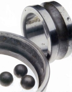

Corrosion results from the chemical attack on the metal by hostile fluids or atmospheres.
Image credit: The Barden Corporation
