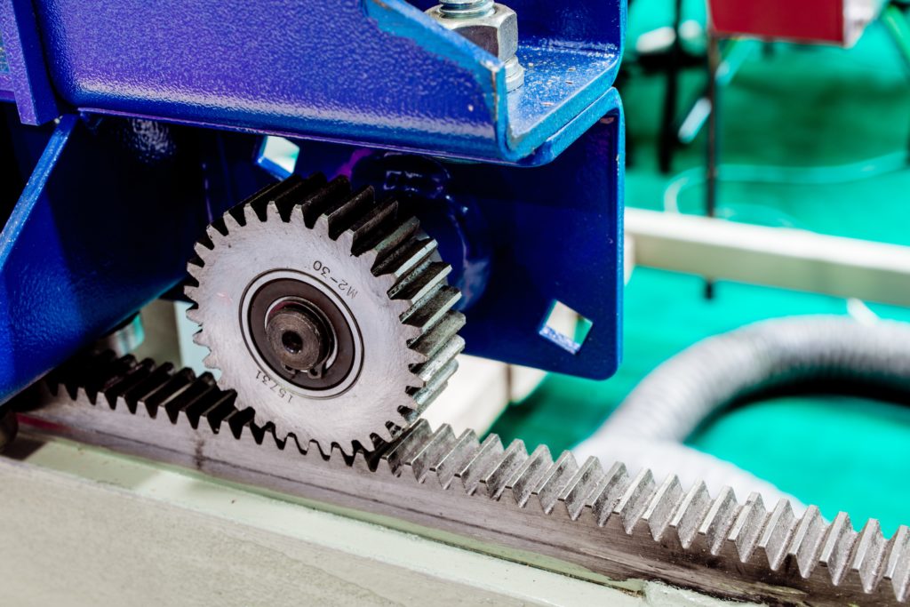

This is a rack and pinion assembly with a helical tooth design.
A rack and pinion system can be used in three basic ways. The first and most common is fixing the rack to the machine structure and using the reaction force on the driven pinion to move a carriage or other platform over the length of the rack — bringing the pinion and driver along with it in high-speed linear motion.

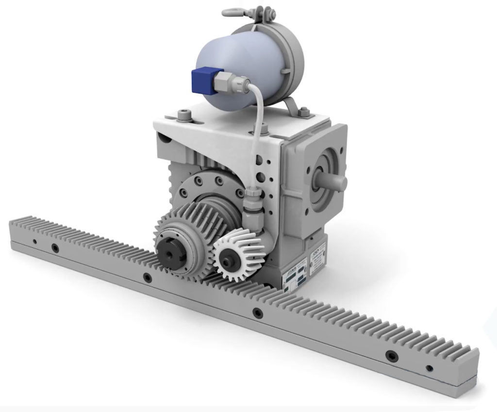

This complete linear-motion solution from Atlanta Drives includes a rack and pinion set with a pinion servo gearhead and automatic lubrication system.

Rack and pinion sets are often driven via right-angle servo gearheads. Image courtesy Atlanta Drives

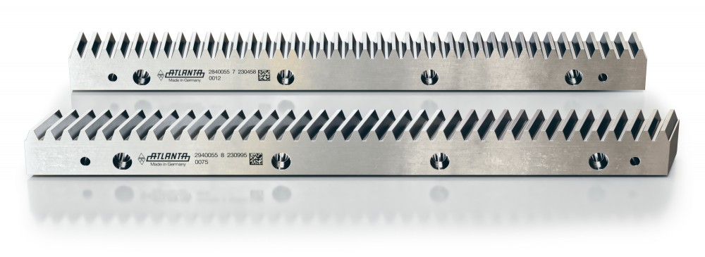

This rack and pinion set has a straight tooth design.
Helical-tooth rack and pinion image courtesy Atlanta Drives

It should be no surprise that the load must be supported. How it’s supported can be critical. When using a helical cut rack side forces up to one third of the linear force can be seen. The guide system must be able to accommodate that. Therefore, linear guides should be specified to not only carry the weight of the load but also resist the side forces from the gear connection reaction. When using a straight tooth rack there are no side forces. That may allow other guide systems, like rollers, to be acceptable. Helical cut rack has some advantages, like higher force capacity and quieter operation. So, consider the application requirements before choosing the rack type. And after choosing the guide type for the rack selected, communicate the guide friction factor. That will be necessary to calculate the needed drive torque.

Refillable automatic “smart” lubrication systems are readily available to meter grease at appropriate quantities and intervals for each application. Gearhead life is more sensitive to starting and stopping torque. Cycles are a key factor in their selection.
Automatic lubrication systems are available to minimize maintenance intervals. Image courtesy Atlanta Drives

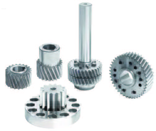

A wide variety of pinion designs are available to maximize drive connectivity. Image courtesy Atlanta Drives
Rack and pinion parameter ten: The input drive system
This involves how the rack and pinion will be driven. In most automation systems a servo motor will be selected because of its controllability. To increase mechanical advantage and reduce reflected load inertia back to the motor a gearhead of some sort is typically added. This could be a planetary inline design or a right angle servo worm. Each has its advantages. In either case, selecting an appropriate gear ratio can have a significant effect on motor and drive costs and performance. Too high a gearhead ratio will slow down the system. Too low a ratio will require a larger and pricier motor and drive.
Another consideration is pinion size. Smaller pinions must run faster to achieve desired linear speed, but require less torque to provide a given force, while also reducing the effects of backlash. A larger pinion covers more distance per revolution but requires more torque to provide the same force. Therefore, properly matching motor and drive size, gear ratio, and pinion size can optimize the system performance in the most cost effective manner.
