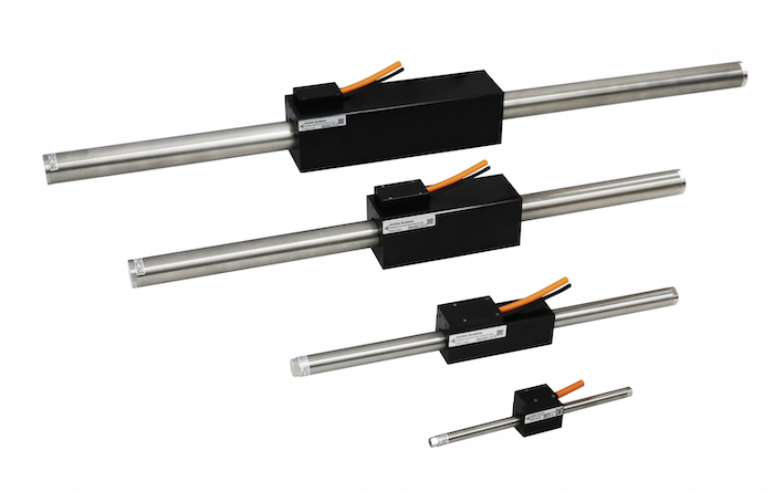

Akribis Systems has announce a new addition to its varied motion control product line: RDM-A Series rod motors for space-constrained applications requiring high motor forces and smooth linear motion.
RDM-A Series rod motors are compact in size and feature a tubular design to distribute magnetic flux evenly along the circumference of the stator. With this approach, they achieve continuous forces from 2.1 to 137.8 N and peak forces from 6.2 to 413.4 N. An air gap between the coil and magnet track enables non-contact axial linear movement and steady force production over the length of the stroke, and ironless construction ensures cog-free motion. The result is high motor forces, smooth motion, efficiency and precision.
linear rod motors
A multi-mover option allows single motor control over multiple movers on one track to simplify complex, multi-axis applications.
