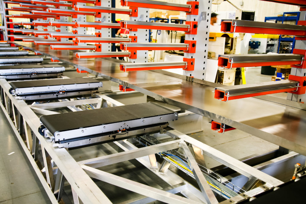

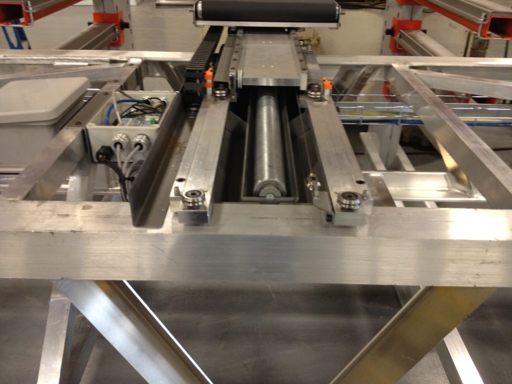

Storing and retrieving 40 ft long sections of carbon fiber required conveyors that could extend into and out of the storage area. Guide wheels and tracks were used to create the necessary telescoping conveyor sections while keeping overall height to a minimum.

Brian Burke, Senior Product Manager at Bishop-Wisecarver Corporation gives an example of a customer who needed to automate the storage and retrieval of carbon fiber segments that were 40 ft long. DualVee guide wheels and linear guide track were used to create double-extending telescoping conveyor sections that could achieve the required reach while keeping height to a minimum.

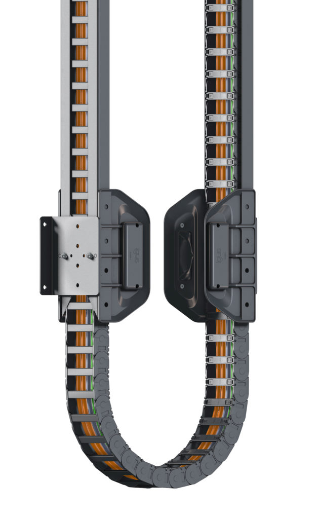

Automated storage and retrievalSupporting equipment, such as energy chains, can also be chosen to minimize space. For example, E-chains with a tight bend radius allow the user to select cables that also have a small bend radius, which shrinks the overall height of the chain. Dan Thompson, Product Manager – Energy Chain at igus, points out, “In vertical applications, the E-chain, if left unguided, could sway and potentially break. But guiding structures take up space, so igus has developed a guide tray that is low-profile and sits very close to the E-chain to minimize the overall width of the system.”

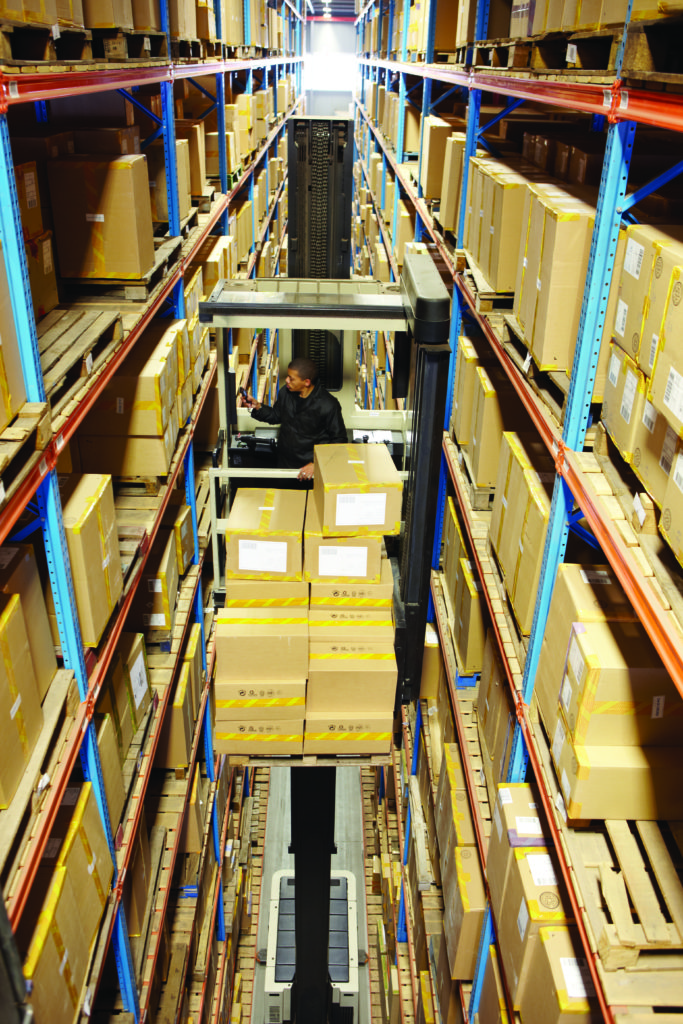

A typical fixed-aisle AS/RS configuration. Goods are stored on fixed racks in totes or cartons. Operators can either pick the goods based on lights indicating the desired tote or carton, or the goods can be retrieved by lift and shuttle systems and delivered to the operator (referred to as “goods-to-operator”) by means of a roller conveyor.
