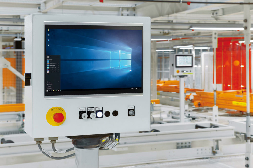

IPCs: Fast processors and large memory
Industrial PCs (IPCs) are, in many ways, similar to standard PCs, but they’re built with more rugged components to withstand the harsh environments often found in industrial applications, such as wet or dusty conditions, temperature and humidity extremes, or vibrations and shocks. Because they’re based on standard PCs, IPCs offer a familiar interface and form factor.
One downside of the standard PC is that it does not deliver real-time, deterministic performance — a necessity in complex applications such as coordinated motion. To solve this problem, industrial PCs often run both a conventional operation system (such as Windows) and a real-time operating system (RTOS) that allows them to provide deterministic control.
motion controller
Industrial PCs offer a familiar interface with better memory and processing capabilities than most PLCs.
Image credit: Phoenix Contact
IPCs offer better memory and data processing capabilities than PLCs, making them best for applications that require intensive calculations and data storage, such as those that integrate vision or imaging systems. IPCs are also able to interface with higher-level plant operating systems, such as ERP (enterprise resource planning) systems, BAS (building automation systems), or SCADA (supervisory control and data acquisition) systems.
