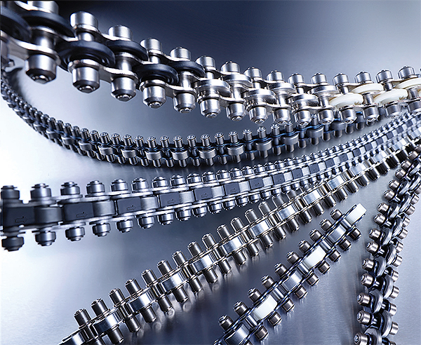

For logistics and material-handling applications, chain engineered for accumulating discrete pieces of product is efficient and durable.
By Gerhard Hartinger • Key Account Manager | iwis Drive Systems
Accumulation chains convey, collect, and separate discrete components. The chains work off electric motors that engage and drive parallel conveyor trains (sometimes called chain strands) on the conveyor edges. The chains run continuously to take conveyed components to set points. At the same time, track rollers support the chain. This is different from traditional drag-chain conveyors that have no rollers.
When pieces of product reach set points, either lift pads, pneumatic pushers, bumpers, conveyor end modules, or other actuators go into action to lift or disengage product from the accumulation conveyor below—and hold, redirect or reorient them for the next production task.
Visit the sister site to linearmotiontips.com at motioncontroltips.com/category/integrated-motion-systems/conveyors for more on conveyors.

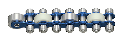

Higher efficiency through low-friction rollers
Accumulation chains having idler rollers on both sides serve two purposes. Idler rollers engage with the sprocket teeth to transmit power. The idler rollers also support the chain in the profile.
In some cases, slightly protruding bushes in the inner link prevent contact corrosion between the inner link and outer plate. Some accumulation chains also have low-friction sintered metal rollers that provide consistent smooth running conditions not slowed by lubricant adhesion. These low-friction rollers increase the chain efficiency by 30% to decrease motor capacity thanks to lower coefficients of friction—or increased potential conveyor length due to reduced forces.

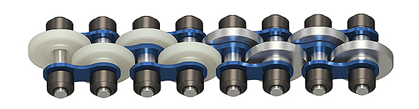

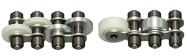

Offset accumulation rollers for load distribution
Note that many standard accumulation chains have a wide roller on every other pin. In contrast, versions with offset accumulation rollers have transport rollers on every pin, so each works as a load-bearing subcomponent. That means twice as many rollers carry load. Ultimately, this setup reduces wear and strain on the chain guide. The rollers’ offset arrangement also maximizes load distribution and supports the load better (for smoother product advancement). More specifically, it reduces localized load on the chain guides by up to 50% so even plastic guides can convey up to twice the normal load.

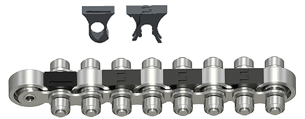

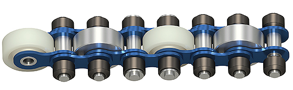

Maintenance-free and covered accumulation chain
Chain with nickel-plated plates and pins and low-friction sintered metal rollers are the main features of maintenance-free accumulation chain. These components negate the need for lubrication and further reduce maintenance costs while helping chain resist wear under extreme running conditions. These chains are common in applications where lubrication is impossible or unacceptable due to risk of contamination—for example, when chain conveys food or medical products, electronics, glass or ceramics.
For improved safety, accumulation chains with safety covers shield the space between one transport roller and the next. This prevents the ingress of small parts that jam the rollers or chain links. Plus the covers prevent deliberate or accidental insertion of fingers while the conveyor is operating; that boosts operator safety. Matched to the chain type and required bending radius, protector shields (either jointed or unjointed) totally cover the space between the transport rollers. Plastic clips permanently fit to chain inner links. There is no interference with conveyed goods, workpiece carriers or transport rollers.
