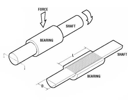

Of the factors to be considered, the most important are the pressure imposed on the bearing (P) and the bearing’s velocity (V). These are combined to develop a PV rating, which represents the highest combination of load and speed under which the bearing can operate properly.
Pressure is determined by dividing the maximum load (force) on the bearing by the supporting area of the bearing.
PV rating
Image credit: Polygon Company
PV rating
Where:
P = pressure (N/mm2 or lb/in2)
F = load on bearing (N or lb)
A = area (mm2 or in2)
For a round bearing riding on a shaft, the supporting area is simply the length of the bearing times its inner diameter.
PV rating
Where:
l = bearing length (mm or in)
d = bearing inner diameter (mm or in)
