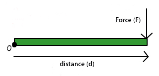

In the simplest scenario, the applied force is perpendicular to the axis of rotation. In this case, torque is simply the product of the force and its distance from the axis of rotation:
torque
what is torque
Image credit: physicstutorials.org

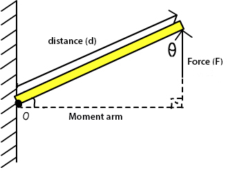

But in many applications, the force does not occur perpendicular to the axis of rotation. In this case, the angle of the force must be taken into account to find the length of the moment arm:
torque
what is torque
