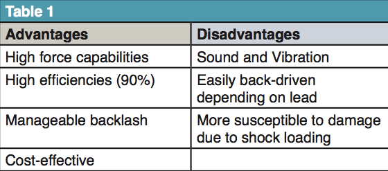

Comparing advantages and disadvantages of ball screws.
The level of backlash within a ball screw design is important. Backlash has an impact on the linear drive unit’s repeatability, meaning its capability to repeatedly, precisely, and continuously reach the same position that it reached before under the same operating conditions. Ball nuts typically have anywhere from 5 to 25 thousandths of an inch of inherent backlash. Beyond choosing a dual nut style design, backlash can be mitigated in a ball screw system by loading each circuit with ball bearings of a larger than nominal diameter. This tightens the gap between the ball bearings and notably mitigates the screw assembly’s inherent backlash.
In most cases, a ball-screw-driven unit’s accuracy, or ability to hit a targeted linear position, is a product of the quality of the manufacturing process used to create the screw and the consistency of the screw thread profile over the length of the stroke. The repeatability attributable to the nut(s) and the accuracy attributable to the quality of the screw must both be considered when evaluating the overall precision of the unit.
When to choose a ball screw drivetrain: Ball screws are great options for applications that call for a high duty cycle, high speeds, and high loads. They are also good choices for when you’re looking for a bit of a torque advantage. The rolling elements inside the ball nuts typically have lower friction than roller and acme screws, which allows them to have a mechanical efficiency of up to 90 percent. This high efficiency makes them perfect for operations where a higher level of performance is required and where screw wear is an issue.
While they offer good performance capabilities, a potential drawback for ball screws in certain applications can be the noise they create in use. This is due to the sound produced by the balls colliding in the return tubes and circulating through the nut.

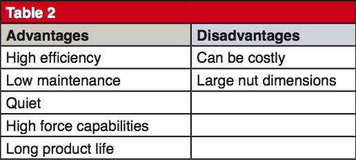

Comparing pros and cons of roller screws.

Machine designers often choose roller screws for complex applications where a moderate to high degree of precision is required. They’re fit to handle more challenging applications as they offer high efficiency, large load-bearing capabilities, and high duty-cycle capabilities. They’re also good options where less system maintenance is desired or for when you don’t want to have to worry about replacing parts as frequently, as roller screws offer an extended product life given the greater contact area on the screw threads.
Roller screws generally produce notably less noise than ball screws during operation. Their noise only comes from the planetary rollers within the nut. Because these planetary rollers make constant contact with the screw surface, the noise level associated with use is less than that of ball screws, whose ball bearings have freedom of movement.
Note that the tight machining tolerances essential to manufacturing these screws have the potential to add to the overall cost of the system. For simpler systems, non-critical functions, or for applications that are less demanding, the higher functionality of roller screws can be cost-prohibitive.
