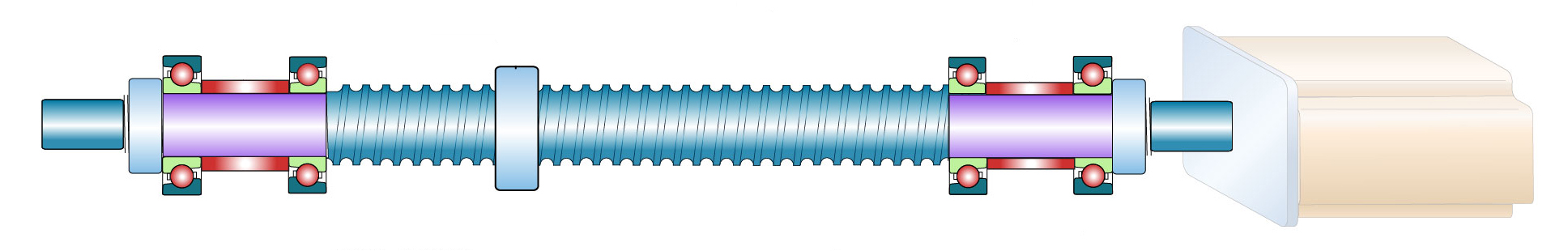

The normal operating temperature for ball screw assemblies depends in part on the type of seals and lubrication used, but generally ranges between 0° C and 80° C. Temperatures higher or lower than these limits, as well as significant temperature fluctuations, can cause thermal expansion of the screw shaft. Case in point, a 1° C rise in temperature can cause the screw shaft to lengthen by 0.012 mm per meter of length. As the screw lengthens, the lead of the screw thread elongates, which reduces the screw’s accuracy.
One method to mitigate the effects of thermal expansion is to mount the screw shaft in tension, with fixed bearings on both ends. This helps to prevent the screw from expanding (or contracting) due to heat (or cold). Forced air cooling of the screw assembly is also a good solution in some applications. A more extreme measure — but one commonly used in applications such as machine tools, where travel accuracy is absolutely critical — is to use a hollow screw shaft with internal cooling to reduce the temperature of the screw material.
ball screws in harsh environments
Mounting a ball screw in tension, with fixed bearings on each end, can help mitigate thermal expansion.
But it’s not just the effect of temperature on the screw shaft that needs to be considered. In fact, virtually every part of the screw assembly can be affected by temperature extremes. As mentioned above, materials for seals can be chosen to meet specific temperature requirements. End bearings also have seals with specific temperature ratings, so the permissible operating temperature of the end bearings should be checked as well.
