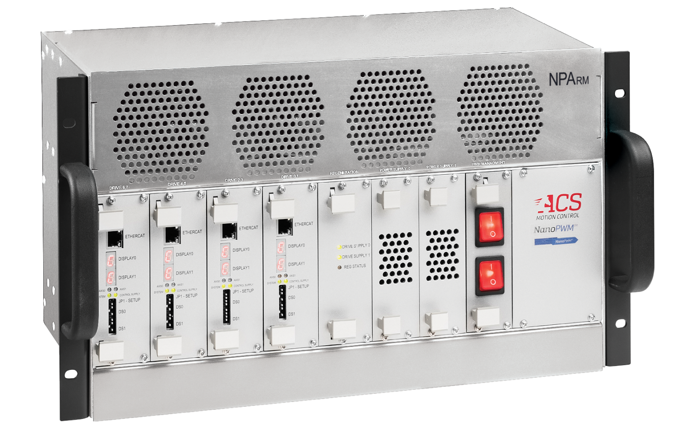

NanoPWM drives from ACS Motion Control exhibit a dynamic range to 200,000:1 so are suited for precision applications — especially when used with features that address natural stage behavior.

NanoPWM motor drives can output ±10-V current commutation commands. The NPARM is an integrated servomotor drive system to operate with any motion controller with ±10-V current commutation commands interface.
