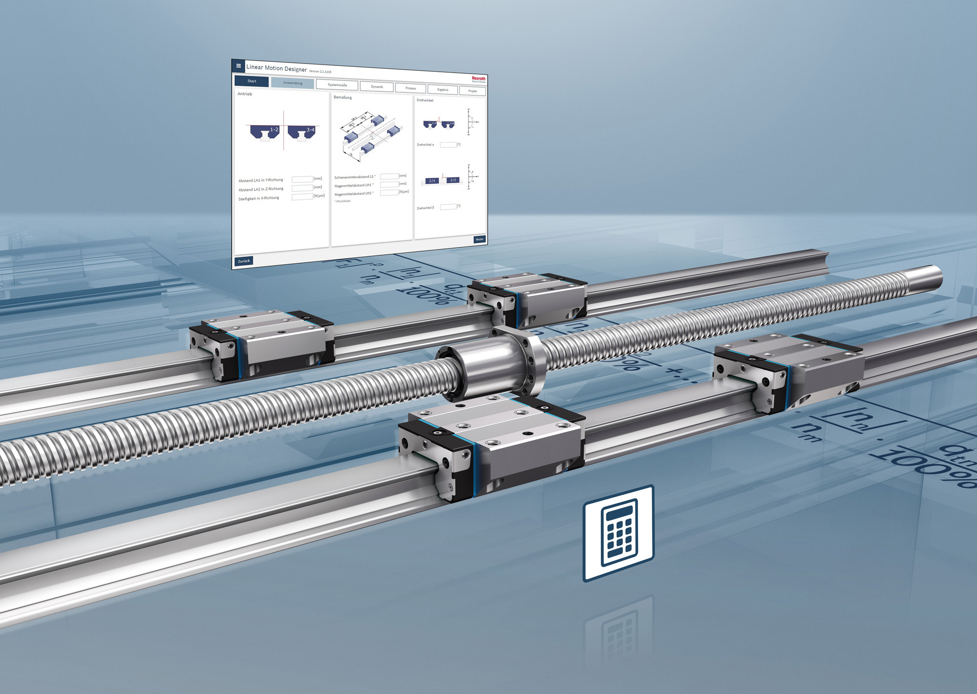

DIY linear-motion solutions from scratch
Complete customization can be perfect for some plant operators and a nightmare for others. What are the benefits? Well, the DIY approach of linear motion design offers the option to customize almost every detail of a machine. Designers can tailor components to the exact needs of the end process because they are basically creating the system from scratch.
But if this sounds like an expensive design approach that requires a decent amount of time to complete, it is. One advantage of DIY motion designs is maximizing labor on the backend … But even here, a plant must ensure it has the engineering power to execute.
Having engineering talent in-house is key for the DIY build approach because of the cost of labor and time it takes to create the system. Hiring out non-recurring engineering to complete the job is an option, but it comes with risks. When using an outside engineering source, the level of control over the design can be slightly diminished. Outsourcing can also create issues down the line if a motion design must be modified but the outside engineering team originally hired is suddenly unavailable.
What’s more, it’s difficult to replicate previous designs that weren’t created in-house. To what kind of process would this level of customization apply? It really depends on the size of production of the machine’s end use. DIY linear-motion builds excel when they’re destined for machines that will be mass produced, or if the market place doesn’t offer a setup to satisfy the end-use requirements.
For machines to be mass produced, OEMs can realize some economies of scale by buying only components they need in volume. Sometimes OEMs can also buy components that are less costly than purchased motion systems that exceed end-use needs. Where the marketplace doesn’t offer a motion design to meet end-use requirements, sometimes the optimal choice is a one-off solution. For example, a custom linear actuator might help meet accuracy and precision requirements or dimensional and environmental parameters. In fact, customization is a major factor when considering DIY linear-motion design builds.
Bosch ballscrew and rail assembly Valin designing profitable solutions linear motion control systems
Separate ballscrews and linear guides are typical components of a DIY system. The one shown here includes a Bosch Rexroth ballscrew and rail assembly.

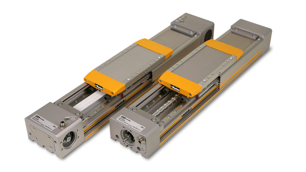

Hybrid linear designs for the best of both worlds
For design engineers looking to drive moderate to minimal system customization, the hybrid engineering approach is the best course of action. Hybrid setups are exactly what they sound like— a little bit of DIY paired with a complete setup. Pre-engineered setups make it easy to mix and match parts of the system without requiring unworkable engineering effort to create and execute the design.
Parker Hannifin linear actuator and motor Valin designing profitable solutions linear motion control systems
Shown here is a Parker Hannifin belt-driven linear actuator and a linear-motor-based actuator — typical components for hybrid linear-motion approaches. In fact, hybrid (and fully turnkey) linear-design builds are usually up and running in a short amount of time. Image courtesy of Parker Hannifin
With components that are predefined and have documented capacities, all a customer must worry about is the final assembly of the pieces. Hybrid linear-design approaches also come with warranties for their components, which can be a reassurance for customers. If there’s a problem with a part and the company doesn’t have specialized technicians to fix it, they can go to the manufacturer for data and information to help resolve the issue.
There’s no overarching best method for designing a linear motion system. What’s best for a machine user depends on their process, operations timeline, and available manpower.
One of the main disadvantages of hybrid setups is obviously a lower level of customization. Engineers are limited to designing by the manufacturer’s standard sizes and width, which can be challenging in some processes. Hybrid linear-design approaches are best for applications that may need a mismatch of manufacturers. If an OEM demands different, specific brands for one or more items, the hybrid design is really the only option. Although different manufacturers are being used for specific items, each one carries its own specifications and warranty.
If a specific subcomponent is defective or wears out prematurely, the designer also has some recourse on replacement. If the end user has damaged their system in some fashion, a replacement part can be bought off the shelf in some cases. If the designer wants to change the stroke or speed, it’s also easier to make changes to hybrid linear-design approaches because the system specifications are all available through the manufacturers.
