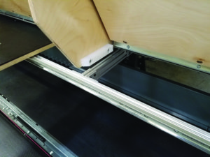

In this recent application, an automated package distribution center was looking to improve its packaging modules. Each module is made up of four chutes that feed packages from the top of the system down to the station operator. The operator is notified of an order and, from there, can pull it out, package it and place it onto a conveyor belt beneath the chutes. The customer wanted to incorporate support platforms onto the design of this existing structure, which the operators could use to box the finished orders.
A few solutions were initially proposed, including a scissor lift, a drop shelf and a motorized, wheeled cart. However, all of these systems would operate apart from the existing module without having to mechanically interface with it. These ideas were ultimately scrapped because they were too costly or had ergonomic problems associated with them, requiring workers, for example, to twist, running the risk of injury.
N-III ended up solving these issues with a simple design that connects to the module and even uses its existing boltholes. For a work surface, the engineers created tables made of strong ply, which they capped with an ABS plastic. These ABS “tops” were water jet cut and served as the template to rout the tables from the ply. The tables were then mounted onto a linear slider, which was mounted simply into a standard aluminum extrusion.
rollon compact rail
To improve a packaging station, N-III engineers created tables made of strong ply capped with an ABS plastic. The tables were then mounted onto a linear slider, which was mounted simply into a standard aluminum extrusion.
From there, workers can slide a table along the length of the chutes to where it is needed—a taping station, for example. While there is one table per four modules, tables can travel freely across up to 12 modules, maximizing design flexibility and minimizing the number of tables that need to be installed.

The success of N-III’s solution is owed, in part, to engineers’ flexibility over the course of the design process. For example, it became apparent that the use of a 1 x 1 inch lateral bar would not be able to accommodate the moment loads created by the weight of the packages on the tabletops. A 100 lb package placed at the end of a table would create a 600 lb load on the supporting structure, pulling the bearing out of the rear track. To ensure that the system could hold up to these loads, engineers first ran a finite element analysis (FEA) test to analyze and compare system stress under loads using a 1 x 1 in. and 1 x 2 in. lateral bar. Whereas the 1 x 1 in. bar deflected, engineers discovered that the 1 x 2 in. bar could handle the high loads of the heavy packages. They therefore integrated this new component into their design.

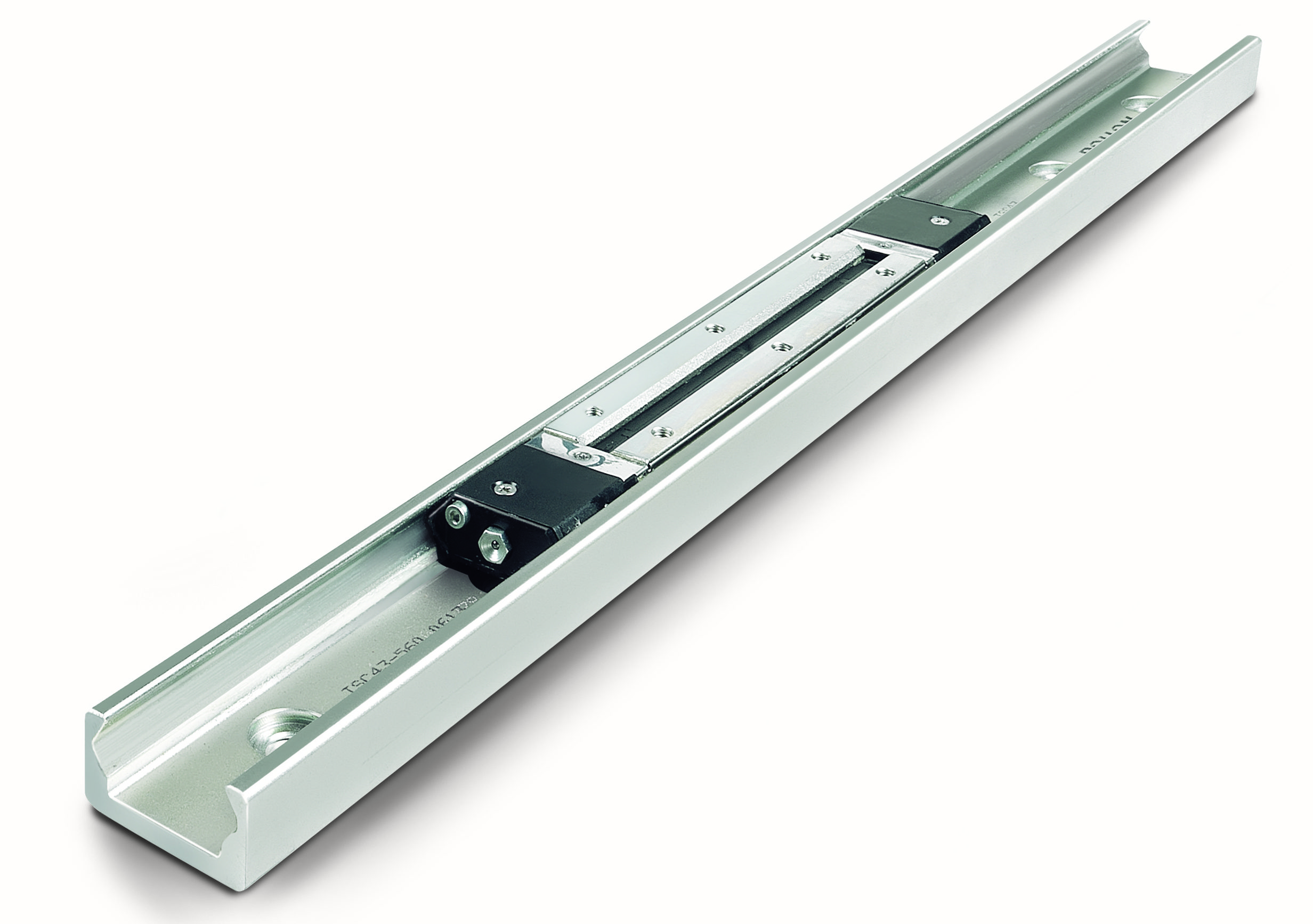

Bearings that aren’t aligned properly during installation can cause problems on any precision machine, resulting in wear or even reduced bearing life. The Rollon Compact Rail system is inherently tolerant of misalignment, thanks to a rail geometry that can absorb alignment errors in one or two axes. Whereas ultra-high precision guides measure acceptable misalignment in arc minutes and microns, the Compact Rail measures it in degrees and millimeters. For example, Compact Rail rollers can rotate up to 2 degrees relative to the rail without affecting function or increasing wear. For machine builders, having a self-aligning system results in greater design freedom and cost reduction. Simple spacing tools make installing to the proper tolerance easy.

Though limited by challenging design constraints, N-III created a supporting structure that mounts underneath a distribution center packaging module, integrating an arrangement of plywood, aluminum extrusions and Rollon linear bearings.

Rollon Compact RailThe packaging module includes tables, which are made of strong ply and are capped with an ABS plastic. The tables were mounted onto a Rollon linear guide, which was inserted into a standard aluminum extrusion.
