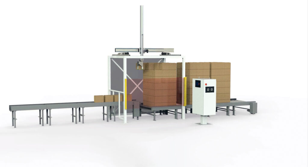

Cartesian robots are a suitable choice for depalletizing applications. Such robots consume less floor space than an equivalent six-axis robot and allow access for the execution of manual operations when needed. Laser-based sensing and custom EoAT let some such robots remove individual boxes from a pallet even if the boxes’ sizes and orientations vary unpredictably.

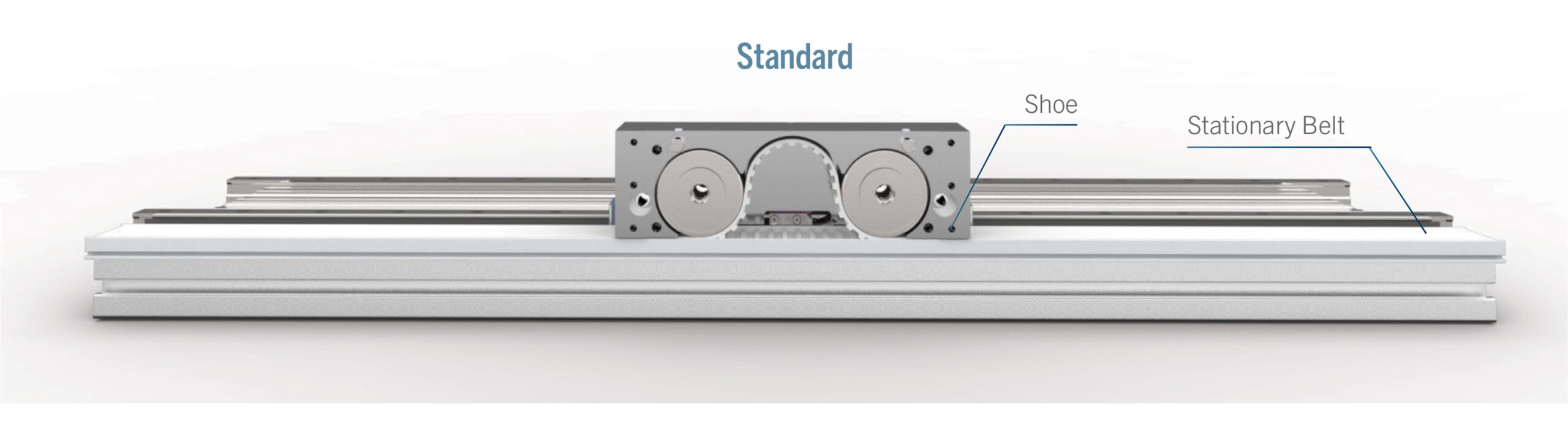

Some Cartesian robots offer strokes exceeding 50 ft even while delivering speeds to 4 m/sec. Standard carriages might include a dual-belt drive technology; some other carriages contain an upper drive belt that continuously loops within. The latter prevents belt sag in inverted or cantilevered arrangements and allows multiple independent carriages to concurrently operate on an axis.
Above: Some long-travel robot transfer systems feature a moving-motor design (in lieu of a conventional recirculating belt system). Motor weight is no issue. It’s true that engineers frequently choose belt-driven stationary-motor designs to minimize the moving payload … but when Cartesian robot lengths reach 4 m, the belt’s weight typically exceeds that of the moving motor. Click to enlarge images.
Long belts complicate Cartesian robot design, as they degrade driveline stiffness (which in turn degrades performance). That’s because maintaining a given tension value on long belts is challenging … and (making matters worse) belt tension is asymmetrical and variable. The issue renders long recirculating belts an underperforming, finicky, and costly choice for accurate positioning.
In contrast, moving-motor linear stages keep belt lengths short and tight and housed within the carriage so that they can respond to encoder-informed controls. Accuracy is maintained regardless of Cartesian transfer-system length … whether 4 m or 40 m.
