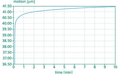

piezo open-loop creep
In an open-loop system, creep can be several percent of the intended motion after an extended period of time.
Image credit: piezosystem jena
Creep always occurs in the same direction as that produced by the change in applied voltage. And although creep is a function of time, the rate of creep decreases logarithmically. For example, the amount of creep a piezo actuator experiences between 10 and 100 seconds is similar to the amount of creep experienced between 0 and 10 seconds.

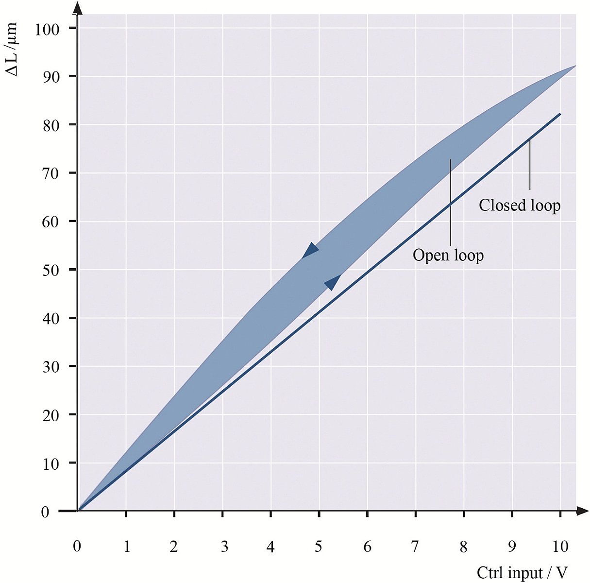

*Although the equations governing piezoelectric behavior predict a linear relationship between applied voltage and displacement, in real-world applications, the relationship is not purely linear. This is because piezo materials exhibit hysteresis — essentially, a lag between the change in voltage and change in displacement, causing the actuator to follow different paths of expansion and contraction as voltage is applied and removed.
piezo open- and closed-loop behavior
With closed-loop control of a piezo actuator, hysteresis and creep (non-linear behaviors) can be virtually eliminated.
Image credit: PI
Non-linearities — including hysteresis, creep, and drift — can be significantly reduced or eliminated through closed-loop control using a feedback device such as a capacitive sensor.
